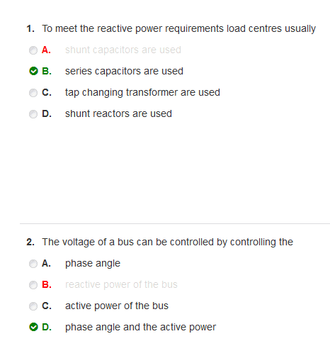

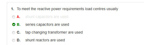

Reactive power requirement requires which element

Screenshot of a two-question multiple-choice quiz; question 1 lists options A to D with B (series capacitors are used) marked correct, and question 2 lists options A to D with D (phase angle and the active power) marked correct.
I think it should be A for 1st and B for 2nd
Shunt capacitor is used to improve power factor by giving reactive power to line.
Series capacitor is used to improve efficiency of line as it nullifies effect of line inductance.
And for 2nd Q proportional to V2/X is the formula.
Am I right or is the pasted answer in picture right?
  • Multiple-choice quiz question 1: To meet the reactive power requirements load centres usually. Options A (shunt capacitors are used) is greyed out in red, B (series capacitors are used) is marked with a green tick, C (tap changing transformer are used), D (shunt reactors are used).

  • Screenshot of a two-question multiple-choice quiz; question 1 lists options A to D with B (series capacitors are used) marked correct, and question 2 lists options A to D with D (phase angle and the active power) marked correct.
