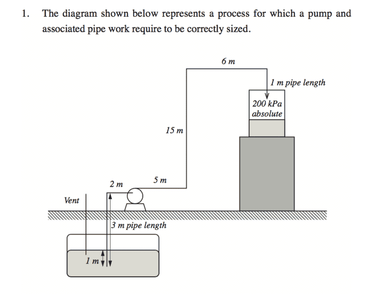

Calculate head required for the pump and then its power requirement assuming 70% efficiency.
The lower storage vessel is vented to atmosphere (assume 1 bar pressure) .
I have the following given information:
Pipe Area = 0.00636m^3.
Flow(Q)= 0.01m^3/s
Average Velocity = 1.57m/s
Density of Fluid = 960kg/m^-3.
Liquid viscosity = 0.081 Pa/s
I have calculated the head losses of the whole system, using firstly the Equivalent Head (Hm) to be 1.03m and Number Velocity head (Hf) to be 0.54m.
Bernoullis
Bernoulli equation written as p1/(rho g) + v1^2/(2g) + z1 = p2/(rho g) + v2^2/(2g) + z2
Pump inlet
## \frac {0} { 960 * 9.81 } + \frac {1.57^2} { 2 * 9.81 \ } + 0 = \frac {P2 }{\ 960 * 9.81 \ } + \frac {1.57^2} { \ 2 * 9.81 \ } + 4 + 0.38 ##
P2 = -41249 Pa
= -0.41Bar
Pump Outlet
## \frac {P1} { 960 * 9.81 } + \frac {1.57^2} { 2 * 9.81 \ } = \frac {200000 }{\ 960 * 9.81 \ } + \frac {1.57^2} { \ 2 * 9.81 \ } + 15 + 1.19 ##
P1= 352470 Pa
P1 = 3.5 Bar + 2 Bar(Pressurised Cylinder)Power = qpgh
= 0.01 x 960 x 9.81 x 19.57
= 1.84 kW
Assuming 70% = ## \frac { 1.84 } { \ 0.7 \ } ##
= 2.63 kW
Is my method correct so I can say the pump required is an 2.63 kW to overcome the 5.5 bar.Any help would be great
Thanks
  • Process diagram: a vented storage tank with 1 m liquid level and 2 m suction height, a pump, a 15 m riser to a 6 m horizontal run, then 1 m pipe length down into a pressurised cylinder at 200 kPa absolute. Pipe lengths 3 m and 5 m labelled.

Equivalent length;
Re=1.572*0.09*960/0.081
Re=1676.8 thus streamlined flow
Friction factor=16/1676.8 =9.54*10^-3
Hf/L =4 (9.54*10^-3 * 1.572^2)/2*9.81*0.09
=0.0534
L = 32 m (total length of pipe)
Hf = 1.7088 m
Le/d = 213 (4 x 90 bends, 1 x entry, 1 x exit)
Cf=16/Re = 9.542*10^-3 (Cf)
Hm=2*Cf*Um^2/g *Le/d
Hm=426*Cf*1.572/9.81
Hm=1.024 (equivalent length method)1.572^2/2*9.81 + 0 + 101325/960*9.81 + 1.572^2/2*9.81 + 2 + Pp/960*9.81 = 1.572^2/2*9.81 + 16 + 200000/960*9.81 + 1.0788 + 1.024=13.011 + Pp/960*9.81=39.970
Pp=26.959*(960*9.81 )
Pp=253889 Pa (2.54 Barg)
H=3+15-1+1.7088+1.024
H=19.733 m
Power required = 0.01*9.81*960*19.733
=1.858 kW
At 70% 1.858/0.7= 2.654 kW
I didn't check all your arithmetic, but your approach is correct. It looks like the OP omitted the frictional and joints resistances, and only used Bernoulli.

If Re<2000 it is a laminar flow then friction factor =64/Re. I'm only an electrical engineer and I saw this equation in a few articles.Why here
f=16/Re?
This explanation is given in many fluid mechanics textbooks :
Friction Factors: Fanning and Darcy
There are two common friction factors in use, the Darcy and Fanning friction factors. The Darcy friction factor is also known as the Darcy–Weisbach friction factor or the Moody friction factor. It is important to understand which friction factor is being described in an equation or chart to prevent error in pressure loss, or fluid flow calculation results.
The difference between the two friction factors is that the value of the Darcy friction factor is 4 times that of the Fanning friction factor. In all other aspects they are identical, and by applying the conversion factor of 4 the friction factors may be used interchangeably.
