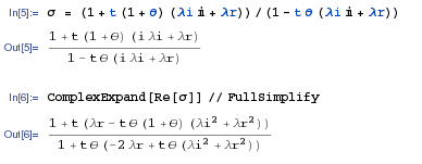

I have some variables that are all real, and I have a few ##i##s, all in a fraction. When I ask Mathematica to give me the real part of the entire fraction, ##Re[]##, it simply echoes my input, not giving me anything useful. Any help is greatly appreciated.

You could try using ComplexExpand:

Yea I've tried this before. I should have been more specific: see what I want is the real component without any imaginary numbers. Like multiplying by the conjugate and simplifying. Do you know if there a built in function that does this?

Look again at my post. That's what ComplexExpand does. There are no "i's" in the final answer.

Ohhhhh shooot, sorry! I saw the variable ##\lambda i## and thought there was an ##i## in the solution. Sorry and thanks!
