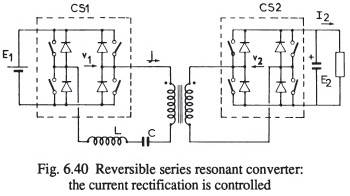

A bidirectional DC to DC converter has the following structure.
People who are talking about switching frequencies like 20, 50 or even 100 kHz , and 100 kW DC/DC converter toplogies involving xfrmr link, are living in clouds. It's not a 100 W table top toy with negligible leakage inductances & parasitics you can lift with two fingers up. It is quite a challenging engineering task to reach 20 kHz at 100 kW as shows the following read: https://hal.archives-ouvertes.fr/hal-01747437/document
