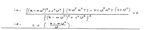

How do we get from the first line to the second?
I can see that the denominator vanishes along with the factor of [itex]\pi\omega^5m^2Y[/itex] in the numerator.
What the hell is the next step? How are they getting rid of the [itex](k-m*\omega^2)^2[/itex] term?
Can some make a suggestion as to how to simplify this? should I expand the [itex](k-m*\omega^2)^2[/itex] ?
Is there some trick or am I mentally challenged this week?

Alrighty... If I expand out the numerator I get something like this:
[itex]k^2-2m\omega^2+m^2\omega^2+c^2\omega^2-2c\omega^2=0[/itex]
Which is a quadratic (where c is the independent var) whose coefficients A,B, &C are:
A=[itex]\omega^2[/itex]
B=[itex]-2\omega^2[/itex]
C=[itex]k^2-2m\omega^2+m^2\omega^2[/itex]
So I have:
[tex]c=\frac{2\omega^2\pm\sqrt{4\omega^4-4\omega^2(k^2-2m\omega^2+m^2\omega^2)}}{2\omega^2}[/tex]
Now where do I go? I see that there 4 coming out of the radicand as a 2 so I get:
[tex]c=\frac{\omega^2\pm\sqrt{\omega^4-\omega^2(k^2-2m\omega^2+m^2\omega^2)}}{\omega^2}[/tex]
Would it be silly to square both sides to get rid of that radicand? Eff it...I'm doing it! Who's with me?

This isn't right. I expanded out the numerator and set it equal to zero. I ended up with the expression:
[tex]k^2-2kmw^2+m^2w^4-c^2w^2=0[/tex]
I then found their answer from this. Is there any reason why c must be positive? Is this some physical problem?

Yes, it is silly to do such a thing. It is a cardinal rule of algebra that you cannot distribute an exponent over addition! You should also give people time to post as well.
Ok, first of all, I am assume that [tex]\omega[/tex], m, and y are constants.
After we dispose of the denominator, we have the numerator equal to zero.
Notice in the first line of the handwritten image you posted, the expression [tex]\pi\omega^{5}m^{2}y[/tex] is a common factor of both terms on either side of the negative sign. If we factor thatou,we get:
[tex]\left(\pi\omega^{5}m^{2}y\right)\left[\left(k-m\omega^{2}\right)^{2} + c^{2}\omega^{2} - 2c^{2}\omega^{2}\right] = 0[/tex]
Now, I can divide both sides by [tex]\pi\omega^{5}m^{2}y[/tex] since it is one big constant:
[tex]\left(k-m\omega^{2}\right)^{2} + c^{2}\omega^{2} - 2c^{2}\omega^{2} = 0[/tex]
Combine like terms:
[tex]\left(k-m\omega^{2}\right)^{2} - c^{2}\omega^{2} = 0[/tex]
[tex]\left(k-m\omega^{2}\right)^{2} = c^{2}\omega^{2}[/tex]
Take the square root of both sides:
[tex]k-m\omega^{2} = c\omega[/tex]
[tex]\frac{k-m\omega^{2}}{\omega} = c[/tex]
Holy Sh** ... i completely missed that factor of "c" in the last term...thanks meiso...
