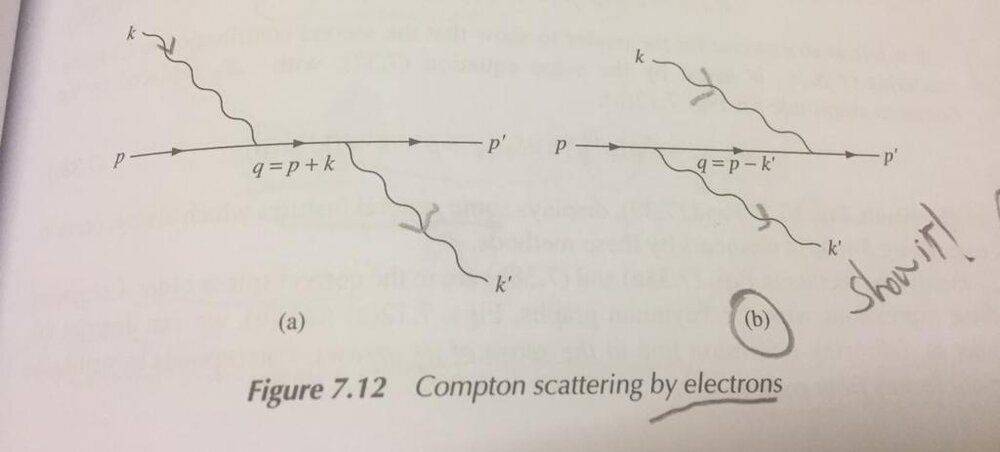

The Feynman Amplitudes associated to these two figures are as follows
$$\mathscr{M}=\mathscr{M}_a+\mathscr{M}_b \ \ \ \ (3)$$
$$\mathscr{M}_a = -i e^2 \frac{\bar u' \gamma^{\mu} \epsilon_{\mu}' (\gamma^{\mu} f_{\mu}+m) \gamma^{\mu} \epsilon_{\mu} u}{2(pk)}, \ \ \ \ \mathscr{M}_b = i e^2 \frac{\bar u' \gamma^{\mu} \epsilon_{\mu}' (\gamma^{\mu} g_{\mu}+m) \gamma^{\mu} \epsilon_{\mu}' u}{2(pk')} \ \ \ \ (4)$$
Where
$$f:=p+k, \ \ \ \ g:=p-k'$$
Eq. (3) is manifestly covariant and must be equivalent (I did not check it out myself though) to vanhees71's equation (6.128).
