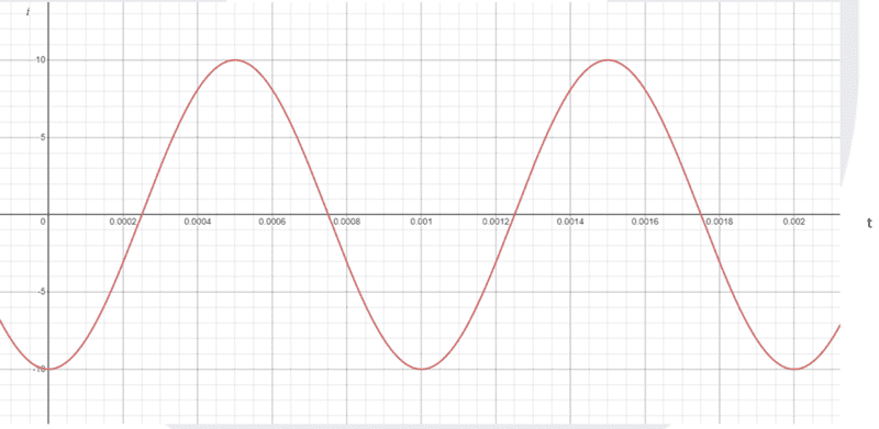

work out what ip, f and phase angle is, then rearrange the formula to make t the subject and find out at what point in time does 6.78 amp occur
i = Ipsin (2pi f t - phase angle)
so far i think Ip = 10 f = 1000hz
struggling with the phase angle

I confirm your amplitude and frequency values.
To get the phase angle, plug in a value for t, read off the y value from the graph and solve the equation. You will need to do that for at least two points because of the ambiguity in evaluating ##\arcsin##.
Can the phase angle not be obtained by noting that at t = 0 the sinusoidal is at a minimum?

I should have written "you may have to". I was trying to be general.
i could be very wrong here, but i worked out the angle to be 90 degrees ?
i full cycle of the wave is 0.001 s and the delay from 0 is 0.00025 s
360 x 0.00025 / 0.001 = 90
That's not what @haruspex suggested ... but I agree.
Easy:
##I = I_p\sin (2\pi f t - \phi)\quad ## pick ##t=0## and solve ##\sin(-\phi)=-1\ ##
Personally, I prefer to imagine the graph for ##\phi = 0## and conclude that a shift of ##-{\pi\over 4}## to the right yields the given graph. Therefore ##\ -\phi=-{\pi\over 4}##
