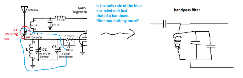

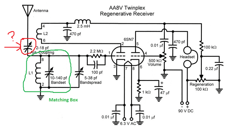

Receiver Circuit Question -- What role does this antenna capacitor play?
The discussion revolves around the role of an antenna coupling capacitor in a receiver circuit, particularly in regenerative receivers. Participants explore its necessity, proper usage, and implications for circuit performance, including sensitivity and selectivity.
  • Some participants question whether the antenna coupling capacitor is necessary or optional, seeking clarity on its proper usage.
  • One participant explains that the capacitor balances the coupling of the antenna input with feedback from the regeneration coil, suggesting it is suitable for short indoor antennas.
  • Another participant notes that the capacitor is essential for the circuit to oscillate, as it transforms the antenna shunt resistance presented to the receiver, affecting the circuit's Q factor.
  • It is mentioned that increasing the capacitance increases coupling, which some participants interpret as a means to adjust the circuit's performance.
  • Some argue that without the capacitor, the performance of the receiver may degrade significantly, indicating its critical role in various types of high-frequency radio receivers.
  • One participant emphasizes that the capacitor provides lossless isolation between the antenna and the tuned circuit, which is necessary for proper feedback adjustment.
  • Concerns are raised about static buildup in external antennas and the need for a DC path to discharge it, which relates to the capacitor's function.
  • Some participants discuss the capacitor's design considerations, such as using metal with an air dielectric to prevent damage from static discharge.
Participants express differing views on the necessity and function of the antenna coupling capacitor, with no consensus reached on its role or the implications of its absence in the circuit.
Participants highlight various assumptions about the circuit's operation, including the effects of antenna geometry on capacitance and the implications of coupling adjustments on circuit performance. There are also unresolved discussions regarding the specific mechanisms by which the capacitor influences oscillation and selectivity.

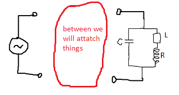

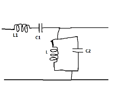

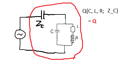

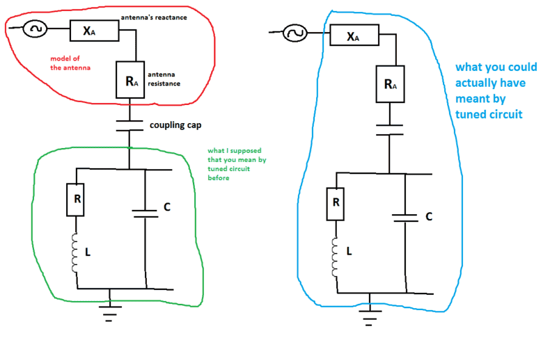

If it's only due to bad notation, let go back to my concern in #29:
Our starting position was that we are going
to model our circuit consisting of a tuned circuit
and an antenna by image in #24.
As you said it's standard to to consider
tuned circuit as "source" and the antenna as "load".
The impedance of the source we call
Z_S= R_S +X_S j and the impedance of the load we call
Z_L= R_L +X_L j.
And what we want is to study what advantage does it bring by adding
a coupling capacitor between the antenna and the tunned
circuit.
As you said the main effect we want to archieve is
to make Q of the source high, right?
Therefore we want to
look how the Q of the source changes if we add a
capacitor ("the "coupling capacitor") in series to the antenna
(= load).
As far as understand it correctly when we add this capacitor
we have to treat it as a part of the new "load"
consisting of antenna + this capacitor, and therefore we
obtain new load impedance beeing the sum of the "old load" -
the antenna impedance Z_L= R_L +X_L j - and the
impedance of the added capacitor.
Next, as you already said we recall that making Q high means
that We want that the load is more than Q times the resonant
reactance X_S?
Now my questions are: Firstly, is what I have written up to now
correct?
And secoundly, as I already asked in #29, The "load",
what is the "load" here it in terms of Z_L, R_L, X_L?
Is my concern a bit clearer now?

  • #35
correct?
Yes.
Z_L= R_L +X_L j.
It is easier to read computer code or text like subscripts, without underline.
Zs = Rs + Xs j ; the source resonator.
Za = Ra + Xa j ; the antenna.
Xc, is the coupling capacitor reactance, which is in series with the antenna.
ZL = Ra + ( Xa + Xc ) j; the effective load impedance.
The magnitude of the load vector is then compared to the reactance of one component in the tuned circuit.
  • #36
Right I, see, and here since we assume that the whole circuit is running at the resonance frequency of the tuned circle, the (amounts of) reactances of the coil and capacitor of the the tuned circuit coincide, so it doen't matter to which one we compare the magnitude of the load impedance, right?
  • #37
Right.
At resonance, XL = -XC ; They are equal and opposite, so the sum is zero.
I use XL when I can, because it is positive.

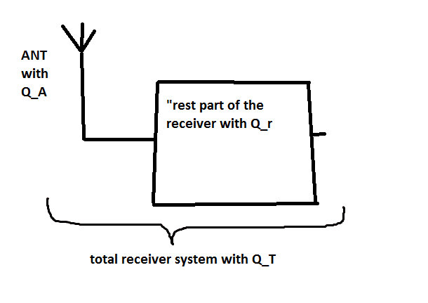

The point is that in a lot of sites dealing with designing receiver/transmitter
networks I saw several times the authors talking about the Q factor without
explicitely explaining to which part of the circuit the Q factor is
associated to.
So this leads me to conjecture (based as well on our previous discussion where you used to impose the matching condition only Q factor of the tuned ciruit and not that one of the antenna) that by convention when one talks about THE Q factor of a receiver/transmitter network one means the Q factor of the tuned circuit. Is this correct?
  • #39
The point is that in a lot of sites dealing with designing receiver/transmitter networks I saw several times the authors talking about the Q factor without explicitely explaining to which part of the circuit the Q factor is associated to.
Can you give a link to an example of that usage.
Have you considered the possibility that it might refer to the Q of the entire signal path ?
A cascade of identical tuned circuit transfer functions will raise the resultant Q by the power n.
  • #40

  • #44
Be careful when talking about Q with RF guys. While they (nearly) all understand the basic concept, they live in a world where that term is used in analogous or sloppy ways. Like "the Q of an inductor" or Q as a measure of bandwidth in a systems that are more complicated than a single resonance. These aren't bad ideas, but they also aren't the strict definition of Q, which, in its many forms, is only a measure of the energy loss of the natural response of a single resonator (a simple harmonic oscillator, to physicists). This often can be confusing if you don't know the assumptions behind their simplifications. If the circuit under question can't be modeled as a SHO, like an LCR circuit, then Q doesn't strictly apply, and assumptions have been made along the lines of "similar to a SHO", "with the impedance at the resonant frequency", "when used as part of a SHO", etc.
  • #45
But the antenna itself is strictly speaking a resonant module of this receiver system as well.
For the broadcast band, the antenna is not resonant and so has a very poor Q.
For receive the antenna must work over the whole band without tuning.
The Q of the tank is therefore critical to selectivity.
The two stages, antenna and tank, must not be tightly coupled, or they will share low Q.
That is why there is a very small coupling cap between stages.
Your OP title was "Receiver Circuit Question -- What role does this antenna capacitor play".

  • #52
Firstly let me try to clarify your concern on the terminology & usage of Q:
Let consider an abstract circuit consisting of several components
(like resistors, coils, caps, etc).
My understanding of Q is that it can be associated to every "elementary"
component (by "elementary" I mean a component of the circuit which cannot
be property decomposed in more elementary components; eg a single capacitor; on the
other hand, eg a LC-tank, can of course be properly decomposed in more
elementary components).
But of course the Q can also be associated to EVERY submodule of the circuit as
well, like eg the total circuit itself or LC-tank or antenna as subsystem,
formally that's always possible. And it's clear to me that since
in general of course a circuit may contain non self-oscillating
components (eg a real resistor), Q should in most general setting a priori
NOT interpreted as something what has to do with bandwidth, in most
general setting Q of a component or submodule should be defined
as quotient of stored energy and dissipated energy per cycle, as you already said.
As I understand it correctly, the interpretation of Q as the reciprocal of the bandwidth
can clearly only applied to Q associated to submodules which
if we keep it sloppy/informal have the properties of a "swinging" system, so which
posses the potential ability to resonate. (of course "everything" can swing,
but let focus on modules which swinging properties are commonly
studied in electrical engineeing.) So the later is a "additional interpretation in special cases", not the main def.
As you noticed with his cat example this sloppy formulation can be
taken to absurdity, but that's a "pathology", let's next focus again on
usual receiver circuits and
the circuit from #19 as a "toy model", where as the common sense "swinging" submodules
should be regarded the antenna, the LC-tank, but the total receiver circuit as well, so
in that case we only limit ourselves to these components the concept
of "bandwidth" is well defined.
  • #53
May I try again to reprase and extract your main point?
If we have a general receiver and we are interested in improving it, then
naively we can always decomope is in "antenna" and "rest part" including
eg tuned LC-tank, demodulator, filter etc:
And of course one important part of the tuning procedure is to
adapt the right receiving properties on our purposes. And these mathematically
are rougly characterized by Q, so we want modify the receiver circuit
by modifying the reveriver's Q, right?
Naively, as in case #19, we have different Q's (which allow
in reasonable sense this "bandwidth interpretation"): the Q_A of the antenna,
the Q_T of the total receiver system (ie with antenna),
the Q_r of the "rest part" (receiver without the antenna), but
we can also of course as I said associate a Q to internal submodules
of the rest part, ie to the LC-tank like in #19.
So do I understand it correctly that theoretically it is
"recommendable" to work with the Q_T of the total receiver system, but
in practice in order to adapt the right bandwidth of the receiver
the considerations on antenna can be neglected, so instead of working
with Q_T, one tends to working with Q_r of the "rest system" simply
"ignoring" the antenna part completely?
So the question is about effort and benefit: how much better our
receiver system with become, if we try to adapt our Q_T with respect
the total system or if it already suffice to with with Q_r for our purposes,
assuming that in practice it's easier to work with rest system's Q_r.
In other words the question is how much better the receiver system would
become if we would try to improve Q_T, instead of Q_r. If the proper improvement
is low, then it suffice to work with Q_r.
Is this what you essentially wanted to say in #45? So that the considerations
on antenna's Q are formally reasonble, but in practice dispensable (probably just because it usually requires some additional effort, if we as you said additionally try to adapt the Q of the antenna and the rest circuit together ), so it suffice to focus on the Q of the rest part of the receiver ingnoring the antenna?
Did I interpret you correctly?

  • #56
My main point is that there must be very little coupling between the antenna and the tuned circuit. Your model of a resonant antenna, tightly coupled to the tuned circuit, is simply not applicable here.
There is only the one tuned circuit, but it is placed inside a feedback loop. The Q of a regenerative receiver is not fixed, it is decided by the degree of regeneration provided. The feedback is adjusted to compensate for almost all the resistive losses in the tuned circuit. That makes the circuit the original Q-multiplier.
Obviously, without feedback the circuit will have poor sensitivity and selectivity. The receiver will be deaf if the tuned circuit cannot be isolated from the antenna.
Feedback regeneration is equivalent to raising the transfer function of the tuned circuit to a greater numerical exponent. Too much feedback and you have a transmitter.
