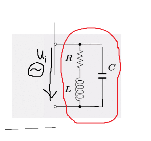

Interesting. So what you mean is that the Q factor
of the tuned circuit considered as the red encircled
thing in image below highly depends on what stuff is in the
magic box on the left, right?

Your irrational line breaks make it hard to understand your reasoning.
If the only losses were the series resistance of the inductor, or the dielectric losses of the capacitor, then the wikipedia simplicity would be correct.
But in the real world there are other networks in parallel with L and C that lower the Q. There is no advantage in having an isolated tuned circuit if it does not have energy inputs and energy outputs.

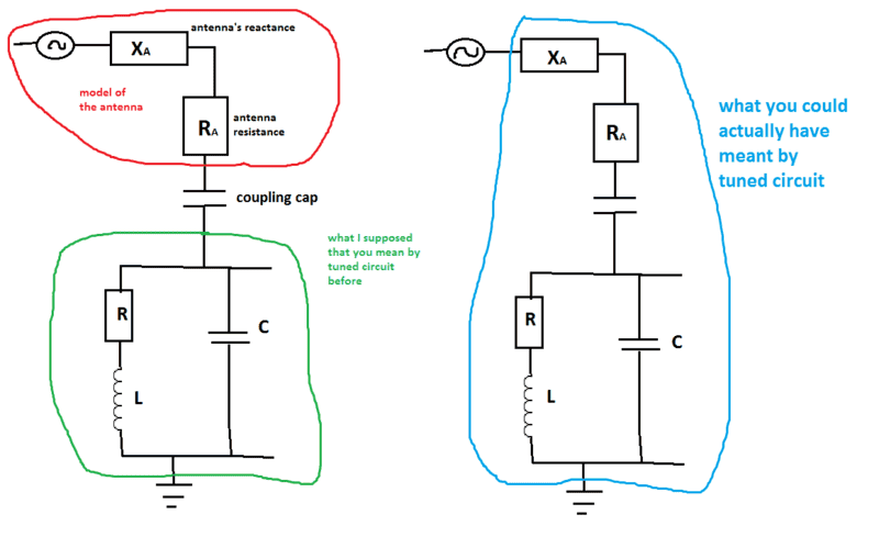

Ok, maybe I understand your point and the reason for my confusion now (correct
me if I'm wrong):
Seemingly we talked past each other on the point what the considered "tuned circuit" should be.
So I guess that you implicitely considered the antenna impedance + the coupling capacitor
as part of it, while I (wrongly?) assumed that when you talked about "tuned circuit" you literally
only mean this LC-thing. In pictures:
Two circuit diagrams side by side: left, a red-outlined antenna model (XA reactance, RA resistance) coupled through a capacitor to a green-outlined parallel R, L, C tuned circuit; right, a blue-outlined version where the antenna model and coupling capacitor are included with the R, L, C tuned circuit.
Well, if you indeed meant by "tuned circuit" the blue encircled thing, then clearly it's Q depends on the coupling capacitor (I conjecture that you meant exactly this thing because as you said the Q of it should depend on antenna losses, while the Q of the green encircled thing has - as wiki formula says - no dependence on the antenna components & coupling capacitor. Did understood your point now correctly?
No.
You cannot draw lines sensibly about components that are connected with wires, because signals travel both ways on the wires and the lines cannot form secure bulkheads.
The tuned circuit is the LC resonant circuit, where energy is circulated between L and C. That may have internal losses that set the maximum Q.
The tuned circuit is also externally loaded.
The external resistive loads further reduce the Q of the tuned circuit.
The external reactive loads change the frequency of the tuned circuit.

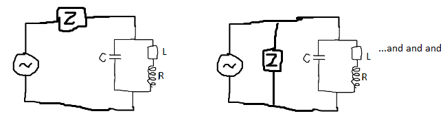

Ok, I think I understand your point. So if we want to study the Q factor of a LC-circuit in the sense you thinking about it, one can rephrase to idea as follows on following elementary example:
Say as an example we want to analyse the function Q of a elementary parallel
LCR circuit in the sense you think about is:
Hand-drawn schematic of a parallel RLC circuit with terminals at top and bottom: capacitor C on the left branch, resistor R and inductor L in series on the right branch.
Then this Q is a function of the three components ##L, C, R## components and the impedance
##Z_E=R_E+jX_E## of an abstract environment component which we can attach to the "scaffold of
the total circuit"
Hand-drawn circuit diagram: a sinusoidal AC source on the left, a red hand-drawn loop labelled 'between we will attatch things' in the middle, and on the right a parallel LC circuit with branch C, and series L and R.
in any feasible way we want, like eg
Two circuit schematics side by side: left, an AC source in series with a box labelled Z feeding a parallel tank of capacitor C and inductor L with resistor R; right, the box Z connected in shunt across the source, with the same C, L, R tank beside it.
ie any configuration how can we attach a or more environment component(s) to this scaffold of
the circuit is allowed.
How to calculate this ##Q (=Q(L, C, R; Z_E))## for a
given environment component with impedance ##Z_E##?
We calculate the ##Q(L, C, R; Z_E)## just as the Q of the TOTAL circuit, ie with the LC-circuit and
the environment component by the techniques from wikipedia/ "stadard textbook methods" how to calculate the Q faction of a fixed circuit.
Eg if the environment compoent is a capacitor parallel to the the LCR-circuit the Q(L, C, R; Z_E) equals to the Q of the total circuit:
Hand-drawn circuit with an AC source on the left feeding a series capacitor Z_E, then a parallel LCR branch with C, L and R, enclosed in a red loop; label Q(C, L, R; Z_C) = Q.
Finally, we observe that the "wikipedia/textbook" Q of the LC-circuit consides with the case when
there is no environment compoent, ie Q= Q(C, L, R; -):
Hand-drawn circuit schematic: an AC source on the left connected to a parallel LCR branch on the right, with C, L and R labelled, enclosed in a red circle.
Did I understood your idea of the Q factor now correctly?
Circuit schematic of a parallel LC tank: a capacitor C in one branch and a resistor R in series with an inductor L in the other branch, with terminals at the top and bottom.
That's a series resonance. Sorry for nit-picking though. In a series configuration low loss requires low resistance. In a parallel configuration low loss requires high resistance.
Yes, I think you've got it. More complex networks can get confusing though and people will either disagree or be sloppy about what Q is. In those cases, I prefer the basic physics approach, where Q is simply an expression of the energy loss that the reactive resonant elements experience. Of course, while the concept is simple, the calculations aren't always. The biggest confusion arises when a network has more than one resonance. I claim each resonance has its own Q (a more mathematical approach), others disagree and will assign a more global definition; one Q for everything (a more functional approach). We are both right, in the proper context. So, for more complex networks, you'll just have to explain the version you are using, I think.
Circuit schematic of a parallel RLC tank: a capacitor C in one branch, and a resistor R in series with an inductor L in the other branch, both branches joining a top terminal and a bottom terminal.
I'm curious @DaveE, if that is a series resonant circuit, could you please show us/draw a parallel resonate circuit?
Thanks.
Your symbol for a zero impedance AC voltage source, that short circuits the tuned circuit confuses things. For this analysis, I simply assume there will be one unit of energy circulating in the tuned circuit at the start of the analysis.
The antenna is a load impedance, Zant.
If you later need a signal from the antenna to model the gain of the circuit, insert a voltage source, Vant in series with the antenna Zant. But that signal source is not needed to understand or model the resonant circuit.
Yes, this is an important concept. A bell is a resonant structure whether you ring it or not. The resonance is all about what happens after you've put some energy in, not so much about where the stimulus came from.
Ok, so it's a matter of nomenclature. If we replace 'parallel LCR circuit' everywhere I wrote it by 'series circuit' as Dave in #77 suggested.
And furthermore if we remove everywhere in my images in #76 the AC voltage source ~ as
Baluncore suggested and instead think of it that in all circuits I draw there is a fixed one unit of energy circulating:
Is then what I wrote about my attempt to understand Baluncore's
interpretation of Q factor after making correction on these two points in
post #76 correct?
