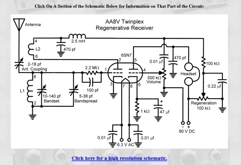

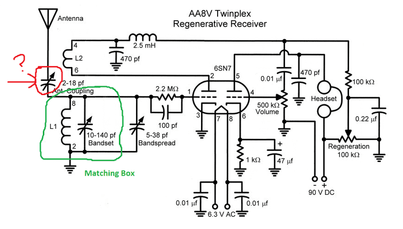

Which role plays an additional capacity in a receiver circuit between the antenna and the matching-box part like in this example (found in https://www.frostburg.edu/personal/latta/ee/twinplex/schematic/twinplexschematic.html):
Is it necessary for this receiver circuit or just optional? What is it's proper usage?

That website appears to have good explanations of each part of the circuit (cool website, BTW). Is there a part of their explanations that you are having trouble with?
What you call a matching box is actually a resonant tuned circuit that selects the frequency you want. If the tuned circuit is too heavily loaded, it will have a lower Q, so less sensitivity and less selectivity.
Both the antenna and the regeneration coil L2 are lightly coupled to the L1 tuned circuit. The series capacitor in the antenna circuit balances the coupling of the antenna input with feedback from the L2 winding. That circuit with the antenna coupling capacitor is suitable for a short indoor antenna.
If an external antenna is used it is necessary to provide a DC path to ground so as to discharge the static electricity that may build up. That would normally involve a tap or a third winding at the earthy end of the L1 coil.
By placing the regeneration coil L2 at the opposite end of L1 to the antenna coupling, radiation of the internal regeneration signal from the antenna is reduced.

Unfortunately in the explanantions on this site I haven't found a satisfying explanation for the importance/ relevance of this this tagged capacity. The only part dealing with it marginaly says:
Antenna Coupling Capacitor:
The antenna coupling capacitor is a critical component in a regenerative receiver without an RF stage, like the Twinplex. In such a receiver, the antenna is an integral part of the regenerative detector, and for proper operation the coupling to the antenna must be easily adjustable. Increasing the capacitance increases the coupling and vise versa.
It is not really answered concretely there what the job of this capacitor is. Except maybe the last sentence I not fully understand: "Increasing the capacitance increases the coupling and vise versa." I guess by "Increasing the capacitance" is meant the capacitance of the antenna. As consequence this rises the coupling (= the resistance of the coupled capacitor, right?) But what is the reason to adjust there this capacitor? Does it preserves the circuit in certain situations from overloading?

The capacitance of the antenna is fixed by antenna geometry.
The coupling of the antenna to the tuned circuit is increased by increasing the coupling capacitance. That is why the coupling capacitor has a value adjustable from 2 pF to 18 pF.
The antenna has shunt resistance, and without the ant coupling cap this is connected across the resonant circuit. This resistance is in parallel with the dynamic resistance of the tuned circuit, and so it lowers the Q or resonant impedance of the resonant circuit, so reducing the gain to the extent that the circuit will not oscillate. It is essential for the circuit to be able to oscillate. The coupling cap has a transforming action, which I can describe later, which raises the antenna shunt resistance presented to the receiver. This raises the Q and allows the circuit to oscillate.
As C is reduced in value, the antenna shunt resistance is raised. The effect of this is easier oscillation but reduced signal strength, so a compromise is required. Generally the coupling cap can be very small, maybe even 1 pF, and most antennas will prevent oscillation if it is not used.

This so-called antenna coupling capacitor is of course necessary. This capacitor is not only used in super-regenerative receivers. Almost all types of high-frequency radio receivers, such as superheterodyne radio receivers, must add this capacitor to the actual circuit. Without this capacitor, the performance of the receiver may become very poor and unusable.
That's the point, right?
Not really.
The capacitor reactance is; Xc = –1 / (2·π·f·C); ohms, reactive. A coupling capacitor provides a lossless isolation between the antenna and the tuned circuit.
If the antenna, reaction coil and tuned circuit were not all isolated to some extent, then only the tuned circuit would be present, and the adjustment of the critical feedback operating point would not be possible.
DC in the antenna circuit is a quite separate issue. The antenna coupling capacitor should be made from metal with an air dielectric, on a ceramic mounting. A static buildup can then arc-over with an audible click each time, rather than destroying the insulation and shunting the capacitor with lossy combustion products that then destroy future performance.
You will appreciate an air dielectric with ceramic spacers once you have heard a crescendo rising to a scream, followed by the crack and then silence of a near lightning strike.
External antennas must have a DC path to discharge static. That is why they have an isolated antenna winding on the tuned circuit coil former, with ANT and GND terminals.

hmmm, maybe my mistake was that I wrongly assumed that the matching box only consists of the tuned circuit. Instead maybe I should think about the coupling capacitor also as part of matching box in light of the pronciple of electrical length?

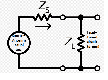

Next attempt to understand it: Perhaps the main task of the coupling capacitor is to adapt the electrical length to the circuit with the antenna (which can no longer be physically changed) matching (en.wikipedia.org/wiki/Impedance_matching) in order to allow as little energy loss (= reflections) as possible?
The key to this seems to be that in order to be able to tap the maximum power by keeping the energy loss as minimal as possible (= perfect matching), the resonant waves in the tuned circuit must be related certain length ratio of the antenna length.
The physical antenna length cannot be changed, but its "electrical length" can be made longer/shorter by adding in series a coil / capacitor.
Is now my approach correct?
The receiver is designed so that the gain can be increased by positive feedback. We need the receiver to be able to just commence oscillation if the positive feedback is increased using the potentiometer. If we place a resistor across the tuned circuit, its losses can be canceled out by increasing the positive feedback. If the resistor is too low in value, the receiver cannot compensate and oscillation cannot be obtained. When we connect the antenna/ground across the tuned circuit it places resistance across the tuned circuit as I have described. Therefore the antenna resistance (considered as a shunt resistor) must be high in order to allow correct operation. The antenna resistance does not have to be matched to the circuit but must have a certain value, high enough that oscillation is easily obtained but low enough so that as much energy as possible is coupled from the antenna. There is an optimum antenna resistance, which for this circuit is not a matched resistance.
The antenna coupling capacitor is a resistance transforming device whose action I will now describe. Let us suppose that the antenna/ground has a resistance of 100 Ohms, a fairly typical value for a quarter wave wave wire and an Earth rod. The tuned circuit alone has a dynamic resistance of maybe 20k. For oscillation, the shunt resistance we are adding from the antenna must be in the order of several kilohms, say 10k, in order to maintain adequate gain for oscillation. The coupling capacitor can transform the 100 Ohms of the antenna up to 10k. Let us suppose the small coupling capacitor has a reactance of 1k. It has 100 Ohms antenna resistance Rs in series so it has a Q factor of X/Rs = 1000/100 = 10. Now a capacitor having a Q of 10, if hidden on a box, might either have series or shunt resistance. If shunt resistance, the value is very high. In this case Q =Rp/X
10 = Rp / 1000
Rp = 10,000
So the capacitor gives us a shunt resistance of 10k which is suitable for the tuned circuit to still oscillate.
The transformation also introduces some reactance across the tuned circuit, but a slight tuning adjustment easily removes this.
For more detailed information look for information on series to parallel conversion.

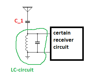

Maybe I should simplify or say better modularize the problem. Consider following part of a receiver circuit, where the we leave a concrete realization on the right hand part literally as "black box".
Say our goal is simply to minimize the energy loss of the signal which is provided to the right for further processing. And the basic question was at the beginning which role the capacitor C_1 concretely plays in this game?
So let's forget the complicated receiver circuit at the beginning and focus on that one:
Is then in this "toy example" the role of this capacitor exactly to change the "electrical length" of the antenna if the antenna is physically to long/short to optimally receive the waves having resonant wavelength with the LC-circuit.
Or has even in this toy example the capacitor C_1 another task?

Again, you are connecting the antenna across a resonant tuned circuit. The tuned circuit needs to have a high Q to be selective and sensitive. The coupling between the antenna and tuned circuit must therefore be light, and so cannot be optimised for maximum power transfer. That is why a small antenna coupling capacitor must be used.
Let me emphasize what @Baluncore said. You don't want efficiency. You want selectivity. You want to hear the station you want, and not everybody else. Efficiency is the last thing you want!

Ok, so our main goal is to reach high selectivity for
the tuned circuit (that's precisely the area surrounded by green
circle) and that's equivalent to requirement that it's
Q is high? (in details that's due to this relationship:
https://en.wikipedia.org/wiki/Q_factor#Relationship_between_Q_and_bandwidth)
(I haven't worked before with the concept of this factor Q and
my rudimentary understanding of it is that in a network the factor Q
can be associated to every swinging subsystem (like in our
case eg the tuned circuit) or more general to every
reactive component (https://en.wikipedia.org/wiki/Q_factor#Individual_reactive_components)
and it "measures" it's ability how underdamped it oscillates ;
is this interpretation of Q correct?)
If yes, let's continue. You wrote, that in order to keep Q of
the tuned circuit high the "coupling between the antenna and tuned
circuit must therefore be light", right?
1. What is the (formal) meaning of "light coupling"?
Can it be expressed in mathematical terms? (sorry, if the question
is too elementary, but such
expression I have never heard/read before)2. Why if we construct such "light coupling"
between the antenna and tuned circuit, the tuned circuit
consequently will have high Q? (and indeed that's what we want)
A1. Light coupling is when the load is more than Q times the resonant reactance.
A2. Q is higher when less energy is lost to the antenna radiation resistance.
On the back of an envelope.
An RF receiver designed for the band from 550 kHz to 1.6 MHz.
One channel, say a 20 kHz window at Fo = 1 MHz. Therefore Q = 1000 / 20 = 50.
At 1 MHz the tuning cap will have a value of about 200 pF.
Reactance Xc = -1 / ( TwoPi * Fo * C ) = -795.75 ohms reactive.
(So XL = -Xc and reactance is sum zero, the resonant inductor will have a fixed value ≈ 126 μH).
For a Q of 50, the parallel load should therefore be over 50 * 795.75 = 39.788 kohm.
A short wire antenna can be modeled as a resistance of about 377 ohms, on a good day.
That value needs to be increased by a factor of about 100 so it does not over-damp the tuned circuit, and kill the Q.
We can either wind a short antenna coupling coil (n/√100 turns) on one end of the tuning inductor;
Or we can insert a reactance of about 39.75 k in series with the antenna. That could be an antenna coupling capacitor with a value of Xc = -39.788 kohms.
C = -1 / ( TwoPi * Fo * Xc ) = 4.0 pF

To make it clearer let make an intermediate step and consider the picture for the general case:
We have a source with impedance Z_S (= X_S + i Y_S with
resistance of the source X_S and reactance Y_S) and
similary for the load with impedance Z_L= X_L + i Y_L.
You wrote on definition of 'light coupling':
And as far as I understand you correctly the coupling capacitor is then considered here as part of the source:
In our example the source consists of the antenna + coupling capacitor (considered
as 'single object' with impedance Z_S) and the load is the tuned circuit, right? Then the
'resonant reactance' is Y_S, but what do you mean by 'load' as numerical value
that you are going compare with Y_S?
My guess: do you mean maybe the amount |Z_L|?And as far as I understand you correctly the coupling capacitor is
then considered here as part of the source; so retrospectively
the source is antenna + coupling capacitor, I asked about the effect of.

There are three loads on the tuned circuit.
1. The vacuum tube grid connection, which is very high impedance so only a minor loss.
2. The regeneration winding and circuit, which is reactive, so not a resistive loss.
3. The antenna connection, is here the most important load on the tuned circuit.
The coupling capacitor is essential to operation here because there is no primary antenna coupling winding on the tuned circuit.

So you claim that if we analyse the Q of a circuit consisting of an antenna coupled to tuned circuit modeled by circuit from post #24 then it doesn't matter if we consider it as receiver or transmitter: the tuned circuit is always the source there, the antenna is the load, right?
And the coupling capacitor belongs then also the load, that is the antenna and the coupling cap in series form the load? Or am I wrong again?
Yes. But for analysis of Q, the diagram in post #24 is labelled backwards with source and load.
It does not matter if the circulating energy in a resonator is increasing or decaying, it will take Q cycles to increase or decrease to within 4% of the final amplitude.
Most of the time it does not matter if it is a receiver or a transmitter being analysed. If it is a high power transmitter you must impedance match better for the frequency being transmitted, or components will be destroyed.
Correct.
Below is what a one tube regenerative radio receiver looks like for reference.
To give another example, this gentleman patiently explained the circuit diagram of his valve regenerative radio receiver, but I haven't listened to what he said in detail.
Most of the time it does not matter if it is a receiver or a transmitter being analysed. If it is a high power transmitter you must impedance match better for the frequency being transmitted, or components will be destroyed.Correct.
It's getting clearer now. So in summary, if consider
our circuit modeled by picture in #24 after swapping
right with left side, so consisting of tuned circuit
as "source" with impedadance Z_S= X_S + i Y_S and
the antenna as "load" with impedance Z_L= X_L+i Y_L .
Finally, what is the essential role of the coupling capacitor?
How I understand it so far:
As you explained in #20 we want our circuit to be selective, so
formally can we archieve it if we make Q of the source
high, right? So we have to do something with our load.
Ok, then as far as I understand it correctly, we do it by adding a capacitor in series to the antenna aka load.
We obtain now a new "load" consisting of antenna + this capacitor, and therefore we obtain new load impedance Z_L= X_L+i Y_L simply as sum of the impedance of old load (=the antenna alone) +
the impedance of this coupling capacitor as "new modification".
Are my reasonings correct up to now?
Next, in A1 you wrote the mathematical conditions which we want to archieve by adding this capacitor. We want that the load is more than Q times the resonant reactance;
As far as I interstand it correctly, the "reconant reactance" is Y_S, ie the reactance of the source
(=tuned circuit), right?
The "load", what is it in terms of
Z_L, X_L, Y_L?
