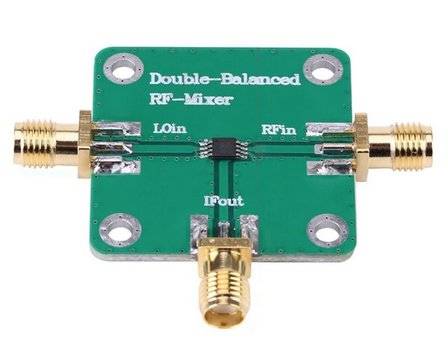

Does a radio or microwave signal, received by an antenna, have to be amplified with external power before downconverting it to be below RTL-SDR maximum detection frequency?
I'm getting this type of device in mail, it is a passive microwave signal downconverter that converts a signal of up to 3.5 GHz to something that can be received with an RTL-SDR of upper frequency limit less than 1.5 GHz. Is it expected that I have to put the antenna-received high freq signal through an amplifier before directing it through this device to the RTL-SDR to listen to it with a computer? The downconverter doesn't need any power source, which is why I'm not sure whether an unamplified signal from antenna is enough.
You do not have to use an amplifier first.
Since mixers make more noise than Low Noise Amplifiers, it is common practice to use an LNA to lift the signal before the first mixer. That can also compensate for attenuation in the transmission lines.
An LNA also provides better impedance matching between the antenna and the mixer.

Thanks for quick reply. So if I understand this correctly, if I put no signal at all (or "DC") to the LOin port, or if if I direct a low frequency sine signal to it, this device just act as a downconverter for what goes in the RFin port, and the downconverted version comes out of the IFout port? Or if the LOin signal is not just simple sine form, then this also acts as a modulator for the RFin signal?
That is correct. A mixer expects a LO power sufficient to switch the internal mixer diodes. Once the diodes are switching, the lower power RF input signals will be down-converted, to appear on the IF output.

The specifications of the circuit read "LO=312". If I want to convert a 2400-2500 MHz WiFi signal to one that can be seen with an RTL-SDR with upper reception limit of about 1480 MHz, I guess I would put a sine wave of more than 1000 MHz in the LO input? Just have to be careful to not use a too large LO input power that can break the device.
Yes, If you put a LO frequency of f_LO into the LO port and your input signal is f_in you will(for an ideal mixer) get TWO two ouput signals with frequencies f_in+f_LO and f_in-f_LO at the IF port. The upper band signal should ideally be filtered away but it is very possible that there is already a LP filter built into your receiver circuit.
it should say in the datasheet how much LO power you will need. Most mixers need quite a lot of MW power, anything between +7 to +13 dBm is quite common and that is a fair amount when talking about MW signals (most MW generators can't generate +13 dBm). However, the mixer will tolerate higher powers that. Under normal circumstances it is quite hard to break a mixer with too much LO Power.

Thanks for the replies to everyone. The only specifications I was able to find yet are like this, but there must be a datasheet somewhere...
Specification: RFin=1.5--4.5GHz
RFout=DC--1.5GHz
LO=312
Noise Factor: 0.6dB
LO/RF Isolation: 40dB
Frequency Conversion Loss: 8.5 dB
1dB Compression Point: 10dbm
RF/IF Max. Input Power: 13DBM
LO Maxi. Input Power: 27DBM
Connector: Standard SMA-female
Material:PCB
Length: approx. 3cm/1.18in
These specs depend on a perfect 50 Ohm source and not the Antenna impedance which may affect LO leakage, which is important and not specified.

LO=312 ? 3 GHz is needed to convert 4.5 to 1.5

This mixer will need an LNA and RF filter to prevent aliasing when LO = 3GHz, then IF filter to remove LO leakage and up.
I wouldn't trust any of these specs.
It requires 1.5 GHz to 3GHz to down-convert.
The conversion gain is LO (dBm) /RF (dBm) yet
LO isolation is only 40 dB from RF in.
I got the device, and when I put an unmodulated 2100 MHz signal from an "ADF3491" signal generator to the "LOin" with as much power as possible, an antenna to the "RFin" and connected the "IF" to an RTL-SDR dongle, I was able to hear the signal from my Wi-Fi router (a periodic tapping sound most of the time, when listened to with AM modulation) at around 310 MHz as supposed. This is when it's using Wi-Fi channel 1 where the signal is found at freqs around 2410 MHz.
Covering the router with copper-nickel fabric made the signal inaudible, and changing the Wi-Fi channel to 11 caused it to be heard at higher frequencies between 2450 and 2480 MHz (or 345 - 380 MHz when downconverted).
