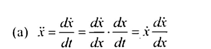

And I know how to solve this kind of equations. We need to use this formula(attached the photo below). I read the formula you rewrote, but isn’t v also related to time? If I move dv to the right and do integration , it gets much more complexed since v is also the function related to time
Your image →
Handwritten derivation labelled (a): x double dot equals d x dot over dt, which equals d x dot over dx times dx over dt, which equals x dot times d x dot over dx.
This formula is useful in the case where acceleration is given as some function of position or velocity, and in some cases both.
In your case it can be used to to find velocity as a function of position.
The equation ##\
\displaystyle \quad \ {dv\over dt} = - {b\over m} e^{\alpha v} \
## can be written as:
## \displaystyle \quad \ v{dv\over dx} = - {b\over m} e^{\alpha v} ##​
Dividing by ##\ e^{\alpha v} \ ## and integrating with respect to position, ##x## give the following,
## \displaystyle \int v \ e^{-\alpha v} \left({dv\over dx}\right) dx = - \int {b\over m} dx ##
