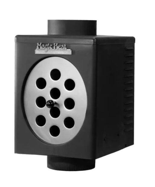

That box is a Magic Heat##^{TM}## heat recovery unit. Link to a randomly selected retailer: https://www.homedepot.com/p/Magic-Heat-6-in-Bottom-Crimp-for-Wood-Applications-MH-6R/205672412.
There is a lot of heat going up the chimney when a wood stove is burning hot during the first combustion phase. I remember seeing the lower heat exchanger tubes glowing red hot.
jrmichler said:
That box is a Magic Heat##^{TM}## heat recovery unit. Link to a randomly selected retailer: https://www.homedepot.com/p/Magic-Heat-6-in-Bottom-Crimp-for-Wood-Applications-MH-6R/205672412.There is a lot of heat going up the chimney when a wood stove is burning hot during the first combustion phase. I remember seeing the lower heat exchanger tubes glowing red hot.
Sounds interesting. Is there a control to turn it off? I've read stories about inadequate flue temperatures and sooting up but it would be good to reduce losses where possible.
I'm in the UK so I will try to locate a local supplier but I have never come across it over here.

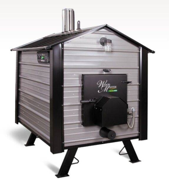

Creosote buildup in the chimney is the result of incomplete combustion, followed by cooling in the chimney. If you have complete combustion, then you can cool the flue gas until water condenses without creosote buildup. Outside wood burners are popular in my part of the world (Northern Wisconsin, USA). These burners are typically loaded with several logs about four feet long, then the fire is regulated by a motorized air damper. The air damper is controlled by a thermostat in the house.
Owners like them because they can load the firebox in the morning, start a fire, and heat the house all day. Owners also like the labor savings of burning four foot unsplit logs. The fire is smoldering most of the time, and the burner emits heavy smoke. Up to 50% of the wood can be lost as smoke. The firebox is surrounded by a water jacket, so the walls are cold. I saw one such wood burner with a full two inches of dry creosote firmly attached to the firebox walls. That wood burner would be expected to also have heavy creosote buildup in the chimney.
Chimney fires are the result of chimney creosote catching fire. Creosote burns much hotter than wood because it is a hydrocarbon with very little oxygen, while wood is about 40% oxygen.
Wood smoke consists of a mix of heavy hydrocarbons, including polycyclic aromatics. Polycyclic aromatic hydrocarbons are the reason tobacco smoke causes cancer.
If you burn wood hot enough so as to not smoke, then you can cool the flue gases as far as you want without getting soot or creosote buildup. the minimum flue temperature is that which creates just enough draft to keep the fire going. The Magic Heat##^{TM}## has a thermostat so it only runs when there is a fire.
Randomly selected internet photo of an outside wood burner:
