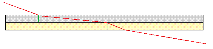

I don't understand. Refraction doesn't minimise the total time to traverse the material, because that would mean that if I put two pieces of 5x10x50cm plastic with different refractive indices next to each other and shined a laser through it at 20 degrees off the surface, it should always attempt to directly through the 5mm direction. I attached a diagram to show what I mean. The blue and green lines represent the shortest distance possible across the material as the laser crosses between each material.
I read up on Fermat's principle, and I still don't understand.
What's minimized is the travel time between two points.
I sort of understand, but it still makes no sense. What defines these points? As light travels in a vacuum, it can't be atoms.I'm trying to think of it from the photon's point of view. As far as I can see, the difference between an opaque and a translucent material is that an opaque material has enough particles per square nanometer (unit is not important) to absorb and re-emit the photon enough times for it to become too low-energy to be in the visible spectrum, whereas a translucent material is less "dense" (I use that in a rough sense - the particles per square nanometer thing again) and doesn't absorb/emit the photon enough times to significantly lower its energy. Though, if this were true I could get red light from blue light using a piece of plastic (less energy -> lower frequency due to E=hf -> different colour light.
What happens to the photons as they navigate through a material? What happens to the photons when they move to a new material with a different refractive index? All the photon comes into contact within a substance is free space and the odd neutron/proton - if it's lucky it'll hit an electron. Why does a change in the composition of a substance alter the direction of light?
It looks like you're visualizing photons as tiny localized pellets which follow trajectories through space like classical particles. They're not.
Why bring photons in it at all? This is a purely classical wave phenomenon.
