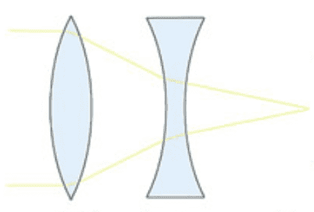

Hello, so I was wanting to use a laser beam and purchase a few lens' online for a project and wanted to get something similar to the image below, where i would end with a horizontal light ray i was wondering if anyone knows the equations that would be required to figure out the distance from each of the lens to the focal point and the angle at which the bend at from lens to lens to the focal point. I suppose I would also have to account for the refraction within the lens also, so is their anything i can use to account for that as well.

Diagram of a convex lens on the left and a concave lens on the right, with two horizontal yellow rays entering the convex lens and converging through the concave lens to a point on the right.
Seems to me you start out with a horizontal (?) light ray and end up with a diverging beam after the focal point...
Thin-lens equations should suffice to get you started, assuming you don't need millimeter-scale precision or better. Try this site and see if it helps: https://courses.lumenlearning.com/boundless-physics/chapter/lenses/
Note that you may actually need to measure the focal lengths of your lenses. Even if they are given, it never hurts to check.
