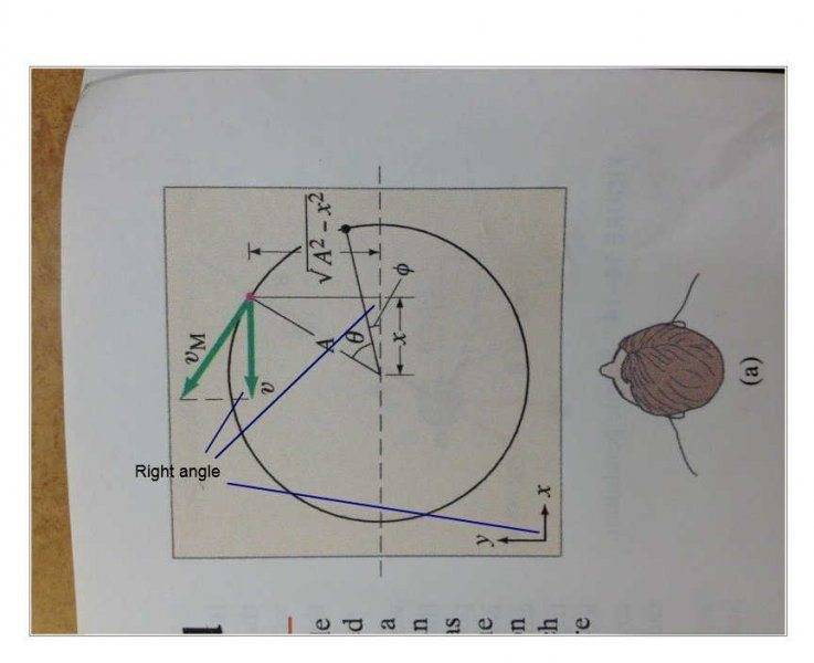

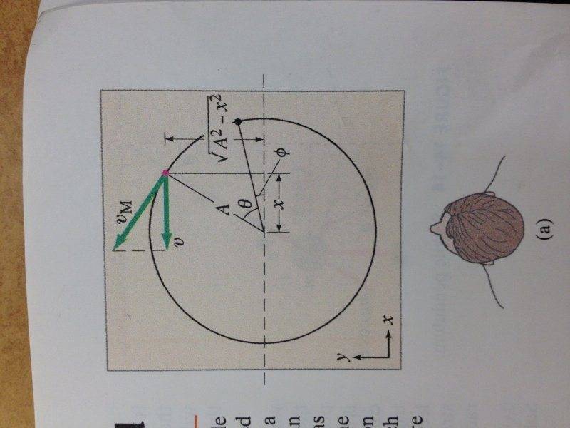

How is ##\frac{v}{v_M} = \frac{\sqrt{A^2 - x^2 }}{A}## derived?
n/a
I don't see a right angle in the picture anywhere, so I don't see how pythagorean's theorem is valid.
I see three.
What do v and vm represent?
SammyS said:
I see three.
Ok, I see where ##\sqrt{A^2-x^2}## came from. However, why are ##v_m = A## and ##v=\sqrt{A^2-x^2}##? According to the picture, shouldn't ##v=x##?
Why did the textbook choose to do ##\frac{v}{v_M}##?
What is it that v and vm represent? What is the context of this figure and the quantities shown in it ?
