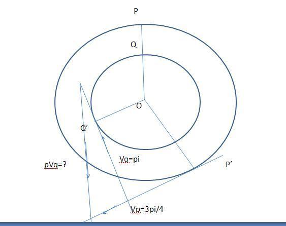

A particle , P moves on a horizontal plane along the circumference of a circle with centre O and a radius of 3m at an angular velocity of pi/4 rad/s in the clockwise direction . A second particle , Q moves on the same plane along a circle with radius 2m and the same centre as the first circle at an angular velocity of pi/2 rad/s in the clockwise direction . At first , O, P and Q are collinear with P and Q located at the north of O . Find the magnitude and direction of the velocity of P relative to Q .
the angular displacement of P and Q are 3pi/4 and 3pi/2 respectively .
The linear velocities of P and Q are 3pi/4 and pi respectively .
then one of the angle of the triangle is 3pi/4
so i can use the cosine rule ,
|pVq|^2=pi^2+(3pi/4)^2-2pi(3pi/4)cos (3pi/4)
|pVq|=5.49 m/s
bu the answer given is 5.09 m/s
where did i go wrong ?

(i assume this is to be calculated after 3 seconds?)
General tip: take out any awkward factors first … then you're less likely to make mistakes, and if you do make one, you're more likely to see where it is.
Then your equation is (π/4)2 times (9 + 16 + 2*3*4*1/√2) = (π/4)2(25 + 12√2) … :wink:

thanks tiny , is my mistake in the calculation in the cosine rule , or the diagram is wrong ?
I think your calculator is wrong. :redface:
lol ! , its in radians mode
thanks a lot !
