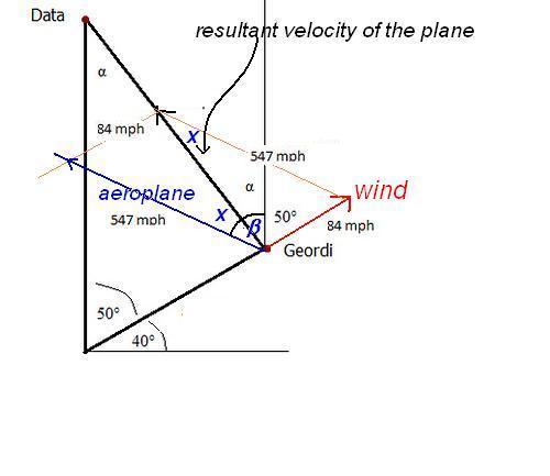

An airplane has a cruising speed (speed of plane with respect to the air) of 547 mph. The wind is blowing at 84 mph 40° north of east. The plane needs to fly from Geordi to Data, which is 982 miles at 28° west of north.
Part A: What direction should the plane head to fly straight from Geordi to Data? (° W of N).
Part B: How long does it take for the plane to fly from Geordi to Data? (hours)
Law of sines?
http://www.flickr.com/photos/28413236@N03/5443668917/
Based on the figure I have made, which is probably incorrect if any pattern can be drawn from the previous 6 hours of failure:
I tried to use law of sines to find alpha:
84/sin(α) = 547/sin(50)
Using the inverse sine I get an angle of 6.76° for α. (This makes no sense as we're given that the direction from Geordi City to Data City is 28 degrees West of North. What is going on here?)

You know alpha, it is the direction of Data from Georgi with respect to North. The resultant velocity is the vector sum of the aeroplane velocity with respect to air, and the velocity of wind. You get a triangle with two sides known, and one angle also known (50+28) apply the Sine Law to get x, and from that beta, the direction of the plane with respect to North.
ehild

the plane will acquire the velocity of the wind too. wind would change its path. so just think how can you remove the effect of wind
