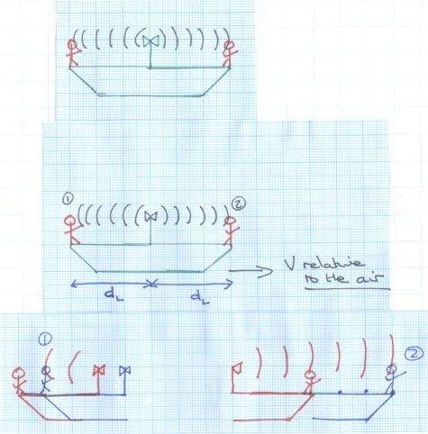

It is a general question just to boost my understanding
Three hand-drawn panels of a boat with a horn and two observers, labelled 1 and 2, showing sound wavefronts. The bottom panels show the wavefronts bunched toward observer 2 and spread out toward observer 1 as the boat moves right.
With a stationary boat both observers hear the horn at the same time as they are the same distance away from the horn.
In the bottom picture of the three pictures above:
If I make the boat move forward through the air at one block per time interval to the right, (the air is the medium the sound wave travels through). The observers are still the same distance away from the horn. The sound waves travel at two blocks per time interval in both directions.
So person 1 hears the sound in one time interval and person 2 hears the sound in 3 time intervals.
Is this above logic sound, (sorry)

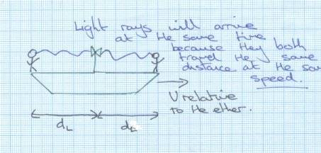

Handwritten note: Light rays will arrive at the same time because they both travel the same distance at the same speed. Below, a boat-shaped sketch with two observers at its ends, a horn marked in the middle, and distance labels d_L and d_R; an arrow shows V relative to the ether.
But with light both observers see the light at the same time and record the same speed for the light wave as it has traveled the same distance to each in the same time interval.

Your explanation for the sound is coorect
Yes. The two observers and the source are all in the same inertial frame, so there is nothing special whether the boat is moving or not.
They will always measure the same speed of light: it is the one thing that is constant for all observers.
And there is no such thing as the ether...
So this situation is ok for explaining that the light waves are not propagating through any medium. So no ether. I suppose I need to go off next and think about the Michelsom Morley experiment. If I understand correctly that experiment was set up to look for the ether. Thanks for your help Dr Claude
