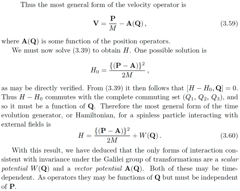

In §3.4 Ballentine states:
The Hamiltonian (3.60) pertinent to the stationary orbitals of hydrogen clearly has ##\mathbf{A}\left(\mathbf{Q}\right)=0##, so from (3.59):$$\mathbf{V}=\frac{\mathbf{P}}{M}\Rightarrow\mathbf{v}^{2}\equiv\mathbf{V}\cdot\mathbf{V}=\frac{\mathbf{P}\cdot\mathbf{P}}{M^{2}}\equiv\frac{\mathbf{p}^{2}}{M^{2}}=\frac{2M\mathbf{T}}{M^{2}}=\frac{2}{M}\left(E\,\mathbf{I}-\mathbf{W}\left(\mathbf{Q}\right)\right)$$from which it follows that:$$\langle\mathbf{v}^{2}\rangle=\frac{2}{M}\left(E-\langle\mathbf{W}\left(\mathbf{Q}\right)\rangle\right)=\frac{2}{M}\left(-\frac{Z^{2}Me^{4}}{2n^{2}\hslash^{2}}+\frac{Z^{2}Me^{4}}{n^{2}\hslash^{2}}\right)=\frac{Z^{2}e^{4}}{n^{2}\hslash^{2}}=\frac{Z^{2}\alpha^{2}c^{2}}{n^{2}}$$as I claimed in post #11.
If you still take issue with this result, I ask that you please describe your specific objection.

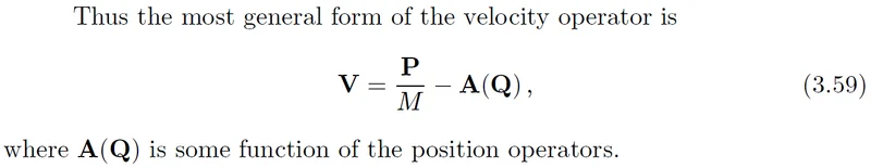

As displayed in post #22, Ballentine explicitly defines the velocity operator ##\mathbf{V}##:
If "it is not observable even in principle and because there's no position that is changing with time" why does he introduce ##\mathbf{V}## in a textbook on quantum mechanics? Moreover, doesn't every Hermitian operator like ##\mathbf{V}## correspond to a physical observable?
Yes, because it's a Coulomb potential, which is purely scalar.

renormalize said:
doesn't every hermitian operator like ##\mathbf{V}## correspond to a physical observable?
In principle, yes, but per Ballentine's 3.37, the relationship between ##\mathbf{V}## and ##\mathbf{Q}## that justifies the term "velocity operator" for ##\mathbf{V}## only applies to expectation values. And the expectation value of ##\mathbf{V}## can only be interpreted as a "speed" for a state which is, to a good approximation, classical. But the state of an electron (or muon, for that matter) in a bound hydrogen atom is not classical even in approximation. So you can't just assume that the expectation value of ##\mathbf{V}##, which is what appears in the quantum virial theorem, has a valid physical interpretation as the "speed" of the electron (or muon). Particularly since, as I've already pointed out to the OP, you can't use non-relativistic QM to analyze a situation where relativity is significant, and ##\mathbf{V}## is a non-relativistic operator (and the Hamiltonian you wrote down is also non-relativistic).

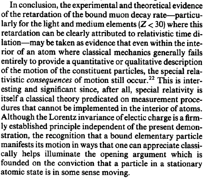

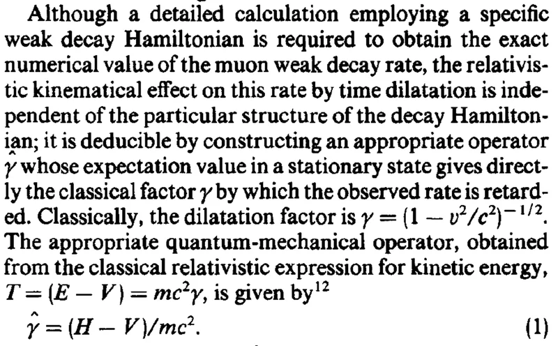

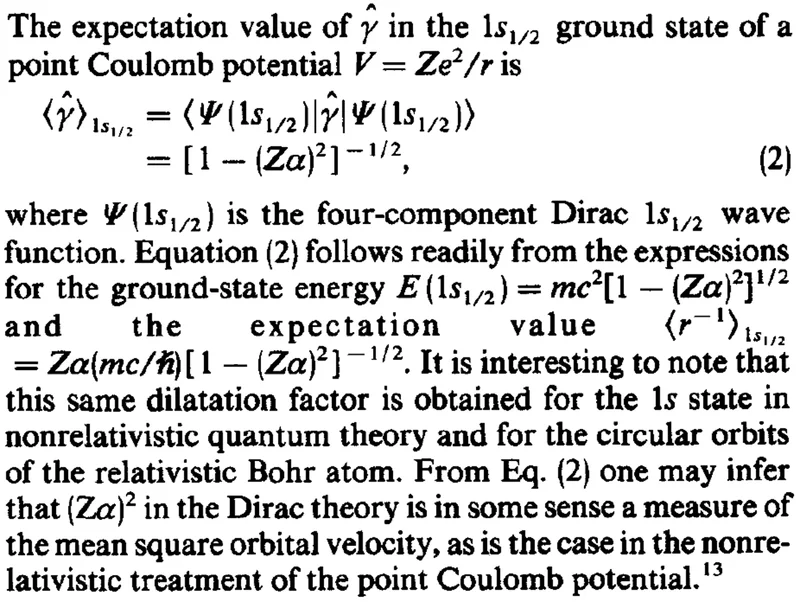

OK, it seems clear that viewing a particle in a stationary state as moving with average speed ##\sqrt{⟨\mathbf{V\cdot V}⟩}## is an iconoclastic interpretation. But at least one physicist promotes that view: I finally got a hold of the paper Relativistic time dilatation of bound muons and the Lorentz invariance of charge that I cited earlier as an answer to @anuttarasammyak's questions. Here are some germane portions:
After discussing the comparison, the author finishes with:
So, for at least this particular author, the decay of muonic-atoms constitutes empirical evidence for both the motion and the time-dilation of quantum particles bound in stationary states. (But in the spirit of full disclosure: his paper has apparently only been cited a handful times in the 40+ years since its publication.)
