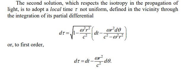

I have two reference frames K, K' rotating with respect to each other. I want to relate the coordinates of these two reference frames
There are two coordinate frames K and K'. A particle is moving. The position of the particle in K frame in (t, x, y, z) and K' frame is (t', x', y', z'). the z axis of K and K' are aligned. and K' is rotating with respect to K with an angular velocity w. Relate the equation of motion in these two frames.
  1. I want the relation between (t, x, y, z) and (t', x', y', z'). [ From one thread I got an answer that t=t', z=z' and other two coordinates are related by sin(wt') and cos(wt') type of factor. However that can not be correct. Let is imagine that the particle is fixed in K frame. In that case in K' frame its moving with velocity wr . Therefore, it should face time dilation and length contraction etc. So I want to know how those coordinates will be related.]
  2. How can we relate the equation of motion in these two coordinates. I mean I want $\frac{d^2 t}{d\tau^2}, \frac{d^2 x}{d\tau^2}, ... $ in term of the dashed coordinates. How can I do that.
There's nothing wrong with the coordinate system in your point 1, but the axes aren't orthogonal. That is why you don't see length contraction-like, time dilation-like, and relativity of simultaneity-like effects. You can construct frames with orthogonal axes so that they share the basis vectors of a locally co-moving inertial frame. I think that only works at one chosen radius, and you definitely have to have at least one discontinuity in your coordinates.
Rotating coordinate systems are much, much trickier to handle in relativity than they are in Newtonian mechanics. You basically need 90% of the maths you need for GR to use them with any degree of ease.
You can use rotating coordinates, just as you can use curvilinear coordinates. However, your metric will no longer be the standard Minkowski form related to an inertial frame and so conclusions as the one you are trying to draw in (1) need particular care. You cannot simply apply the conclusions reached from considering coordinates in an inertial frame.

Sorry, I don't understand. Let's say all the coordinates are orthogonal in K. Now in K' frame the particle is moving with velocity wr. So, the particle's time will show some time dilation and t cannot be equal to t'.
Can you please elaborate? Maybe I have some problem in understanding.
No it will not. While the spatial coordinates are still orthogonal in K', the time coordinate is not.
That the time coordinate is not orthogonal to the spatial coordinates imply you cannot just lift some of the results that appeared in regular Minkowski coordinates (the coordinates of an inertial frame). In particular, to compute the proper time passed by the particle, you cannot simply apply a factor ##\sqrt{1-v^2/c^2}##. You need to compute the metric and apply it appropriately.

Thanks for your reply.
Thats what I said. In K frame all are orthogonal. But not in K' frame.
So, what will be the metric in the K' frame. Do you have any idea or any reference? It will be helpful.

What kind of coordinate transform? Thats what is the question. One thing you can do is
## t = t' ##
## r = r' ##
## \theta = \theta' + w * t' ##
## z = z' ##
But there is the problem. In this coordinate transform you are assuming that ## t = t' ##. How can that be true? Because in the ## K' ## frame the particle is moving with velocity ## r w ##.
So please explain properly what the correct answer will be and what I am doing wrong. Please explain with full mathematical details not with 1 line comments.
Yes, ##t = t’## is fine. That just means the time coordinates have the same values everywhere. However, ##t’## has different coordinate lines from ##t## because the spatial coordinates are different.

The factor in front of ##dt’^2## is not ##c^2##. It needs to be ##c^2 - \omega^2 r^2## to reproduce the time dilation for an observer at rest in the rotating system for which ##v = \omega r## in the inertial frame.
Edit: You also cannot ignore the ##dt’## terms in ##dx## and ##dy##. This is precisely where the off-diagonal terms arise!

Langevin calculated in 1937 the Sagnac effect and showed 2 solutions. The first solution:
Source:
https://www.gsjournal.net/Science-Journals/Historical Papers-Relativity Theory/Download/2523
This metric formula (written with primed coordinates in the rotating frame) can be derived with your transformation:

The second solution:
