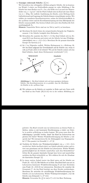

Heres the question.

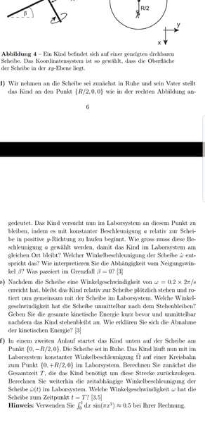

The part I'm referring to is d...I'm afraid its in german.
Can you read it? The upload quality is pretty bad..
This might be better

I missread the question myself and missed some crucial details, apologies. Here is the question.
Inclined rotating disc:
We consider a frictionless, rotatably mounted disc which is inclined at a constant angle β relative to the Earth's surface, see Figure 4. The disc has a radius of R = 2 m, a thickness of 5 cm and a mass density of ρ = 1 g / cm3.
On the plate is a child with a mass of m = 30 kg. The finite extent of the child, as well as friction due to air resistance and storage of the disc can be neglected. We choose a spatially fixed coordinate system so that the disk surface rotates in the xy plane and the origin of the coordinates coincides with the center of the disk. The system is under the influence of gravitational force Fg. Note: Numerical values are to be calculated only in part a) and b). d) We assume that the disc is initially at rest and that his father puts the child at the point {R / 2, 0, 0} as shown in the figure on the right. The child now tries to stay at this point in the laboratory system by starting to move in positive y-direction with constant acceleration a relative to the disk. How big should this acceleration be, so that the child remains in the same place in the laboratory system? Which angular acceleration of the disk ˙ω corresponds to this? How do you interpret the dependence on the angle of inclination β? What happens in the limit case β = 0?
So in this case the weight of the child will cause a torque which will beginn to accelerate the disc. The childs acceleration would have to be (d/dt w)*R/2, is that correct? On a side note would it be correct to say that if the kid was dropped on the disk after the disk was already rotating the kids acceleration would also have to have an x component for him to remain in place?

Ok, I get it at last! My mistake was to interpret "acceleration relative to the rotating disc" as acceleration relative to a neighbouring point on the disc. That is not the same as acceleration in a frame of reference rotating with the disc.
If A is a fixed point next to a disc centred at O and B is a point on the edge of the disc currently passing A, the actual acceleration of B is towards O. So the acceleration of stationary A relative to B must be away from O. Yet an observer at B sees A as accelerating towards O.

Yes, but don't forget that the child's attempt to stay in place will also affect the torque.
In order to stay in place in that context the child would need to have her feet moving to match the disc speed on landing. Thereafter, it is the same problem as before - the right tangential acceleration will keep the child in place.
(R/2*30*(sin(b)+a)/Moment of Inertia)*R/2 = a. Is this equation for determining a correct?
I am having trouble picturing what is even meant by this childs acceleration. I guess what is meant is what is the childs acceleration in the rotating frame of reference which is the disk? From the point of view of the disks frame of reference the child is rotating with an increasing velocity isn't it? If something is rotating with an increasing velocity doesn't it have a tangential and a radial component of acceleration? Am I making any sense?
No.
Let's take this in steps. What forces act on the child? What equation does that give?
What forces act on the disc?
The way I thought was that the childs weight creates a torque of R/2*30kg * sin(b). I also thought that the Force for the childs acceleration has to come from friction so this will create a torque of R/2*30kg*a. So then I thought since T=d/dt(MOI*w)=MOI*d/dt w I would get d/dt w = T/MOI. Lastly I thought that acceleration is equal to R/2 d/dt w...
