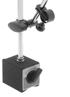

Or do you mean how to switch a permanent magnet on and off? This is a magnetic base for dial indicators:

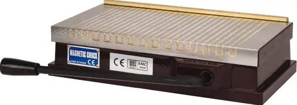

The lever switches the permanent magnet base on and off. And this is a magnetic chuck used in machine tools:
It also has a lever to switch the magnets on and off.

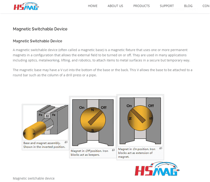

In both cases, the lever rotates an internal permanent magnet so that the base/table surface is either magnetized or not magnetized.
