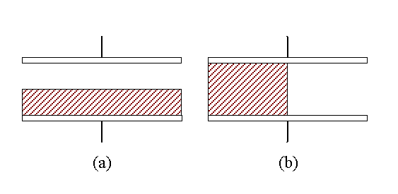

Consider a parallel-plate capacitor, with two square plates of side [itex]\mathrm{12.0 cm}[/itex] separated by a [itex]\mathrm{4.50- mm}[/itex] gap. Half of the space between the gaps is filled with a material of dielectric constant [itex]\mathrm{K = 3.40}[/itex], while the rest is filled with just air.
(a) What is the capacitance, in [itex]\mathrm{pF}[/itex], of this configuration?
(b) An [itex]18.0V[/itex] battery is connected across the plates. How much energy is stored in the capacitor?
(c) The dielectric is now removed from the gap, and nothing else is changed. How much energy is now stored in the capacitor

The space is filled with a dielectric in such a way that it is equivalent to two parallel plate capacitors connected in parallel.
So the configuration is like (b) below, right?

Hold on! Only one of your capacitors had a dielectric. If they were physically separate and unconnected then the voltage of the one that had the dielectric would change by k, but the other would not. Since they are physically connected in this case, you cannot assume that the assembly as a whole will be altered by factor k when the dielectric is removed.
Rather than working with the voltage which changes, why not work with the charge which must remain constant when the capacitor is isolated? What's the expression for the energy stored in a capacitor in terms of the charge?
Yes.
Is my treatment as separate capacitors ok for part b?
The energy stored in a capacitor in terms of charge is [itex]U = \frac{Q^{2}}{2C}[/itex]
So, I should be able to do this by saying the initial charge on the capacitor is [itex]Q = CV[/itex]
When the dielectric is removed, the effective capacitance is reduced to that of a simple air filled parallel plate capacitor, with Q held constant.
[itex]Q = C_{eff}V = 18(6.24 \times 10^{-11}) = 1.1232 \times 10^{-9} C[/itex]
Once the dielectric has been removed, the effective capacitance of the system is [itex]C_{eff} = \frac{\epsilon_{0} A}{d} = \frac{\epsilon_{0} \times 0.0144}{0.0045} = 2.83 \times 10^{-11} F[/itex]
The energy stored in the capacitor is now [itex]U = \frac{Q^{2}}{2C} = \frac{(1.1232 \times 10^{-9})^{2}}{2(2.83 \times 10^{-11})} = 2.23 \times 10^{-8} J[/itex]
Yes.
Yup. Looks good!
