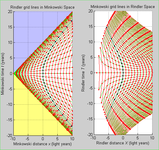

I know kev is well aware of Rindler coordinates, those of an observer in a Born-rigid accelerating rocket in flat spacetime (i.e. in the absence of gravity). They are related to Minkowski coordinates (t,x) (in 2 dimensions for simplicity) by
[tex]ct = X \sinh \frac {aT}{c}[/tex]
[tex]x = X \cosh \frac {aT}{c}[/tex]​
Relative to the Rindler observer undergoing constant proper acceleration a at [itex]X = c^2 / a[/itex], there is an event horizon as [itex]X \rightarrow 0[/itex], corresponding to the photon worldline [itex]x = ct[/itex]. The Rindler observer dropping an apple from his spaceship will see it drop towards the horizon at a distance of [itex]c^2 / a[/itex] below him, but it will take an infinite Rindler time to get there. (When I say "see", in this case it applies equally to optical observation or Rindler coordinate calculation.) However, from the point of view of any inertial observer, (including the apple itself) the apple reaches [itex]x = ct[/itex] in a finite time, crosses without impediment and continues. There is no accumulation of matter at the event horizon, no switch from real to imaginary time, no singularity in any physical sense, just a singularity in Rindler coordinates.
This demonstrates the general principle of how a coordinate singularity at an event horizon can be removed (but in flat instead of curved spacetime).
(Note that performing the change of variable
[tex]R = \frac{1}{2} \left( \frac {aX^2}{c^2} + \frac{c^2}{a} \right)[/tex]​
makes the parallel between this and the Schwarzschild to Kruskal-Szekeres transformation even clearer. See this old post[/color], rescaled here to give R the units-dimension of distance. The thread of that post gives further information about Rindler coordinates for anyone not familiar with them.)

DrGreg said:
... The Rindler observer dropping an apple from his spaceship will see it drop towards the horizon at a distance of [itex]c^2 / a[/itex] below him, but it will take an infinite Rindler time to get there. (When I say "see", in this case it applies equally to optical observation or Rindler coordinate calculation.) However, from the point of view of any inertial observer, (including the apple itself) the apple reaches [itex]x = ct[/itex] in a finite time, crosses without impediment and continues. There is no accumulation of matter at the event horizon, no switch from real to imaginary time, no singularity in any physical sense, just a singularity in Rindler coordinates.
This is indeed true, but are Rindler coordinates (acceleration in flat spacetime) exactly equivalent to curved spacetime?
There are many reasons to think they are not exactly equivalent and we have explored some of the ways they differ in previous threads. For example I can equally use Rindler coordinates to "prove" that there is no central singularity in a black hole in the same way that you "proven" there is no singularity at the event horizon. If you draw a straight line vertically on a Minkowski chart (representing an inertial path) it clearly shows that the falling particle never arrives at a final destination that is equivalent to a central singularity or a singularity anywhere else for that matter. Clearly singularities are a feature of curved space which does not show up in flat space, so using flat space to justify an assertion about curved space is not rigorous Maybe someone can tell us if distinction between the strong equivalence principle and the weak equivalence principle is relevant here?
In fact if you look at the graph you posted in the Rindler thread
, it can be claimed that the Rindler chart has nothing to say about the region below the Rindler horizon and that is why there no worldlines in the blue and yellow regions of your Minkowski diagram, so to me it, it is difficult to justify that a particle “continues” past the Rindler horizon using Rindler coordinates, because the Rindler coordinates do not cover that region. The black curve your Rindler spacetime chart is the path of an inertial observer. It terminates at the Rindler horizon. Can you plot how the black curve of the inertial observer extends beyond the Rindler horizon on the Rindler chart using real values?
(Note: The black line in the first Minkowski chart is an accelerating observer).
Of course they're not equivalent, DrGreg was just showing that Rindler coordinates have some features that are analogous to Schwarzschild coordinates. Curvature is a real geometric aspect of a given spacetime, so there's a real physical distinction between a spacetime that's curved like the Swarzschild spacetime and flat Minkowski spacetime which isn't curved, you can't erase this difference with your choice of coordinate systems.
Uh, what? If we create a coordinate system on a globe that only covers the region of the globe North of the equator, do you somehow believe that an object traveling South would cease to exist when it crosses the equator? Again you must distinguish between the geometry of a surface and facts about a coordinate system drawn on this geometric surface (which may fail to cover the entire surface, as with a coordinate system on a globe that only covers the region North of the equator, as with Rindler coordinates which fail to cover the yellow and blue regions in Minkowski coordinates which do cover the entire Minkowski spacetime, and as with Schwarzschild coordinates that fail to cover regions III and IV in Kruskal-Szekeres coordinates which do cover the entire maximally extended Schwarzschild spacetime)
