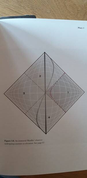

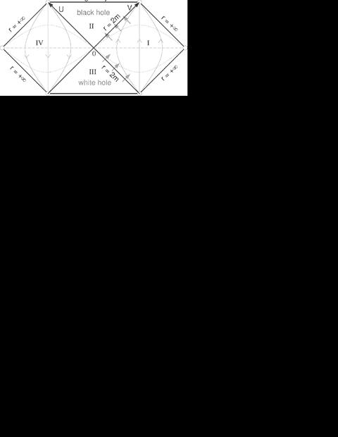

Dear all,
recently I was brushing up my knowledge of black holes with (among others) Zee's "Einstein gravity in a Nutshell" and encountered the analytical continuation of the Schwarzschild black hole in the famous Kruskal-Szekeres coordinates (Zee: chapter VII.2). The corresponding diagram can be translated into a Penrose diagram, which I attached for reference. My question is quite simple: I'm confused about the exact location of the wormhole in this diagram (or the Kruskal-Szekeres diagram for that matter). Should I identify both singularities of the black and white hole in this diagram such that topologically the diagram becomes a cilinder? What happens exactly with the physical singularity? Don't you eventually hit it when you enter the horizon? How can one reconcile the idea that geodesics terminate at the singularity with the idea of a wormhole bringing you to region III or IV in the Penrose diagram?
Many thanks!
continuation of the Schwarzschild solution.

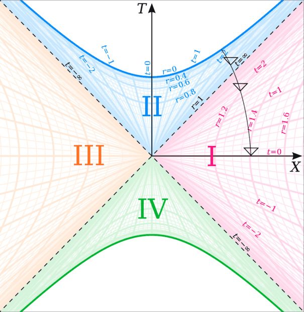

X marks the spot - it's in the middle, both on Kruskal and Penrose diagrams. Note that both lines of the X represent spherical surfaces of radius 2GM, so it's not actually a point. Passing through that X in any direction is where the nested spherically symmetric surfaces stop getting smaller and start getting larger again, but since the radius isn't zero it's not just like passing through the center of a polar coordinate system on flat space.
Timelike worldlines may pass through it from the white hole to the black hole. Ingoing null worldlines that lie on the white hole horizon pass through it and become outgoing (outward into the other exterior) worldlines on the black hole event horizon.
Note that literature is not consistent in the numbering scheme. I and II are usually consistent, but III and IV can be named either way around. This has confused me before. I suggest referring to them by names - something like black and white hole interiors, and exterior and mirror exterior.

Ok, so observers in region I cannot enter the wormhole then, only observers in region III? In this case my confusion about "hitting the singularity" is also removed (I guess it was a coordinate confusion instead of a physical confusion :P )
Correct. Only spacelike paths can reach the wormhole from either exterior region.

Actually it's not just at that spot; that spot is simply where the throat of the wormhole is at it maximum size. At earlier times the wormhole throat is expanding to that size from zero; at later times the wormhole throat is contracting from that size to zero. The reason it is impossible to traverse the wormhole is not that only spacelike paths go into it, but that any timelike path that goes into it gets trapped by the contraction of the throat and forced into the singularity instead of escaping out the other side. This is somewhat easier to see in the Kruskal chart than the Penrose chart because of the way the latter distorts the spacetime inside the horizon (pulling the singularity "up" to a horizontal line instead of being a hyperbola).
Only spacelike paths can reach the point of maximal size of the wormhole throat (from the exterior region--as noted in another post, timelike paths from the white hole region can reach this point, but they also are forced to go into the black hole region from there). But that does not mean only spacelike paths can enter the wormhole. See above.

...wait, so the entire interior of the black and white holes counts as "wormhole"? And that's why I can see into both exterior regions from inside the black hole? Or is there some specific part of the diagram that's considered to be "the wormhole"?
Any spacelike 3-surface which connects the two exterior regions counts as a constant time slice of the wormhole (at least for some time slicing), because any such 3-surface will have the same topology as the ##T = 0## surface in Kruskal coordinates, ##S^2 \times R##, which is the "wormhole" topology. It is a matter of convention what portion of each of these surfaces to call "the wormhole" as opposed to "the exterior regions". To say that the wormhole is "closed", you need to have two disconnected spacelike 2-surfaces, each of which only includes one of the two exterior regions.
In the Penrose chart, all of the spacelike 3-surfaces of constant "Penrose time" connect the two exterior regions and have the topology described above, so all of them are "part of the wormhole". That is why I said that the Penrose chart is not the best chart to use for the "wormhole" description. In the Kruskal chart, if we normalize the coordinates in units of ##2M##, then we can say that for ##T \le -1##, there is no wormhole and the two exterior regions are disconnected; for ##-1 < T < 1##, the wormhole starts growing from zero throat size to maximum throat size, then shrinks back down to zero size; and for ##T \ge 1##, again there is no wormhole and the two exterior regions are disconnected.
If we consider a timelike worldline that tries the best it can, so to speak, to go through the wormhole, it would go as close as possible to the antihorizon in Region I (the right exterior region), would cross the horizon as close as possible to the bifurcation point, and would continue to try to stay as close as possible to the antihorizon after that. To such an observer, it would seem like they entered the wormhole but found it closing too fast for them to exit out the other side, and they would end up hitting the singularity instead.
