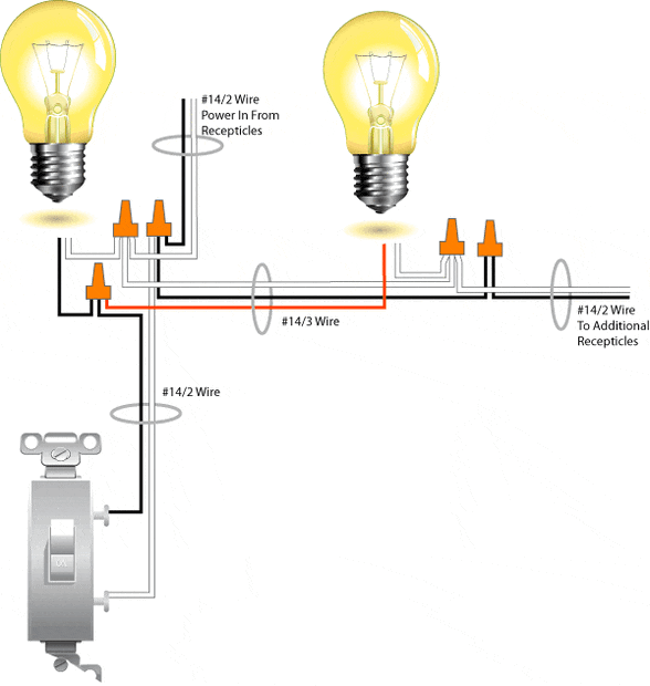

I wouldn't hesitate to run a new circuit from the breaker panel if necessary. Depending on your locality it is quite possible you can add a single new circuit without pulling a permit.
Couple of points: Watch for box fill limitations. This applies to all cases, but especially if you take power off of an existing circuit. You will kick yourself if you suddenly realize you can't squeeze everything back in by adding another cable to an already full box.
This should give you some guidance.
https://www.ecmweb.com/content/article/20886012/box-fill-calculations
If you tap into an existing circuit, keep in mind how heavily loaded the existing circuit already is. Rule of thumb is each outlet (outlet includes ceiling fixtures also, not just plug in receptacles) consumes 180 watts. So the limit on a 15 amp 120 volt circuit would be 8 outlets figuring with the 80% continuous rule. This is NOT a rule of the NEC. It's just good practice. Consider also getting left in complete darkness if all of your lights in the basement are on one circuit if a breaker trips. You will need to use GFCI receptacles in unfinished spaces. So if your floor is bare concrete you will need GFCI receptacles.
Not sure on the latest concerning arc fault circuit breakers. I suspect just about any living space now requires them. Hope this helps. If you have any other questions I'll try to answer.
Edit: One of the main things I wanted to mention and forgot. Do not tap off the laundry circuit. The circuit that runs your washing machine needs to stay just that. If you have a basement bathroom do not tap off of that circuit either.

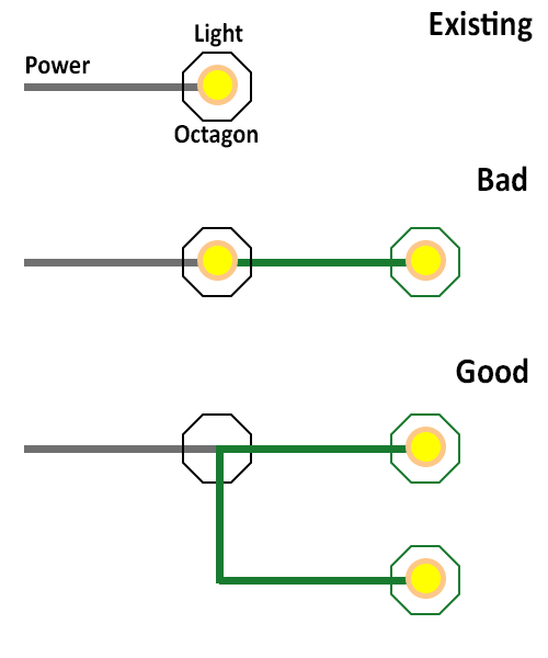

How can I provide light and wall outlets to a storage room without running a line back to the box?
I ran a lights and plug off an existing octagon in my old house, and some electrician pointed out you're not supposed to run a new line off like that from an octagon. But it was a pretty general, cryptic comment.
I wonder if all he meant was that, in general, it's best practice to run a line back to the box, because they way I had done is loading up an exisying circuit that may or may not be able to handle the increased load.
It's also possible all he meant was you're not supposed to double-purpose an octagon (as in diagram 2). That a split in a circuit should be in its own box (as in diagram 3).
That is not inherently true. Go by what was said in my previous post.
It's not uncommon at all to run a cable out of a ceiling box on to feed the rest of the circuit. Just watch for exceeding the box fill limit.

Yeah, what that link describes is not uncommon. I recall doing something like that with the last house I was involved with wiring. Nothing wrong with it. 3 conductor plus ground wire is often used for such things.
After occupancy sensing switches became a thing the neutral is required at the switch. Many cable going from the switch to the ceiling end up being three wire now even if the feed stops at the switch box first. This is so at some point if a ceiling fan is put in there is a constant hot in the ceiling. Don't think just because it's a little more complicated (very little) means it's not recommended.
