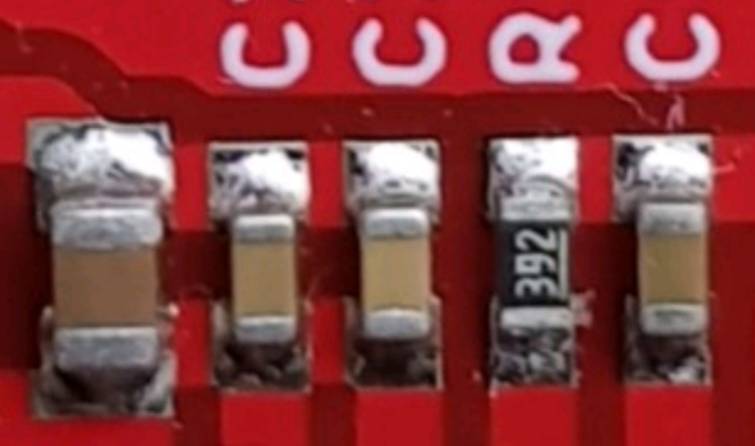

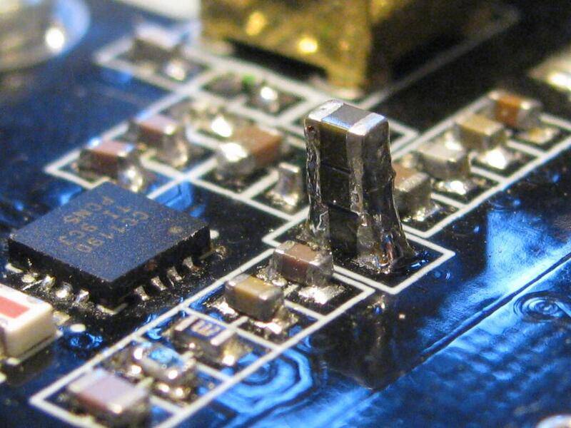

Hi,
What techniques would it be possible to replace 0603 capacitors which has size only of 0.063 in x 0.031 in (smaller than a mosquito?) (see attached image with the C indicating the 0603 caps)
If this is extremely difficult, what services out there that can replace 3 or 4 0603 capacitors in single PCB only? If none, can anyone replace mine?
Also can one just replace 0603 capacitor with normal size capacitor with the same say 10 microFarah (and others)?

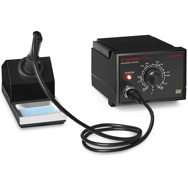

What kind of soldering iron(s) do you have? Do you have a hot air soldering station?
Do you have a desk magnifier (lens)?
I have a desk magnifier and ordinary small tip hot iron soldering unit only. But as soon as I used, it, the plastics in the PCB just melted.
Can you borrow a 2nd iron? What kind of iron do you have? I'm guessing it's not a Metcal...

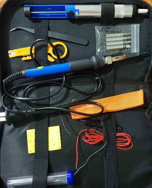

See my soldering set attached. I already used smaller tweezer to remove the old 0605 in the right most capacitor. I just wanted to change the values to alter the cut off frequencies. Can I just use an ordinary normal size capacitor and just solder the wire legs of them to the PCB?

In my personal experience 1206 are reasonably easy to solder/replace (you just need magnifier and some testing to find the best temperature of the iron). I admit I never tried with the smaller ones but I know people who did and from what I remember they used exactly the same kind of soldering station and solder tip I have.
However, I am using a soldering station similar to the one on the picture - as far as I am aware it is a cheap clone of some successful design, can't remember details. $40 or less.
That iron does not appear to be compatible with soldering small SMT components. You need a temprature-controlled soldering iron like the one @Borek posted or a Metcal unit.

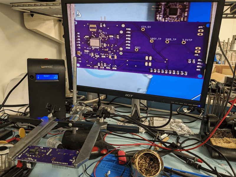

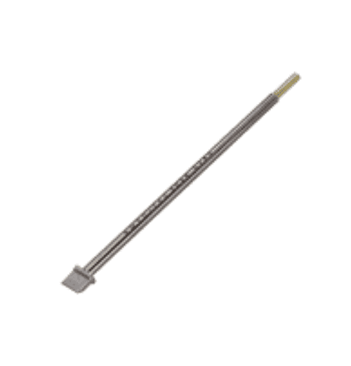

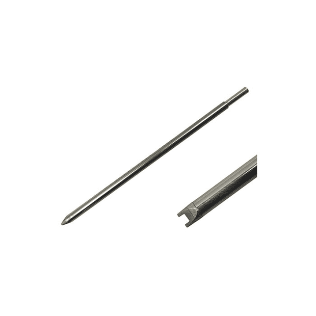

Or the lovely flat blade tips METCAL has for doing inline packages (SMTC-106, I think).
1700441803836.pngI use those to remove 0603 and 0805 components, particularly when not worried about the component's welfare. They clean the pads nicely also

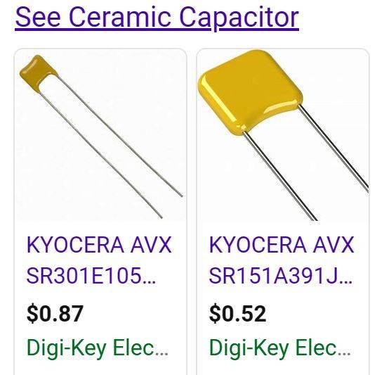

I want to lower the capacitance. Why can't I use a big ceramic capacitor like in the attached picture? I can just easily solder the two legs in the pcb.
For rework purposes for testing, sure. For production purposes, obviously no.

hutchphd said:
Or the lovely flat blade tips METCAL has for doing inline packages (SMTC-106, I think). View attachment 335800View attachment 335800I use those to remove 0603 and 0805 components, particularly when not worried about the component's welfare. They clean the pads nicely also
METCAL is an addiction. Once you pay the admission price it's never ending series of fixes. Most of the prototype boards use METCAL for soldering.
