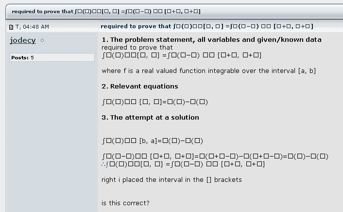

required to prove that
where f is a real valued function integrable over the interval [a, b]
∫() [b, a]=()−()
right i placed the interval in the [] brackets
is this correct?
You just assumed that the antiderivative of f(x-c) is F(x-c). Why is that true?
i believe it was given in a lecture i had so i assumed is that a wrong assumption?

You are probably not aware, but the way you posted makes your post unreadable to at least XP Windows users using Chrome, IE & Opera, attachment shows what they see. It looks little bit better under Vista, but is still barely readable.
I have corrected thread subject.
