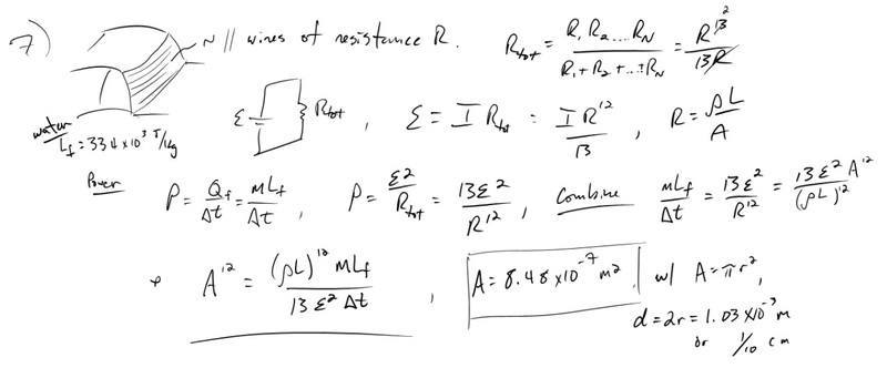

My car has rear defrosters that are made of 13 wires embedded into the rear window. They can melt a thin layer of ice, roughly 2.25*10^-2 kg worth, in two minutes. These wires are all in parallel and are connected to the 12V battery of my car. Each is about 1.25m long and has a resistivity of 9.00*10^-8 Ω*m. What is the cross sectional area of each wire?
R=ρL/A
Q=mLf
P=Q/t
So, I submitted this homework a while back. My instructor finally posted solutions. In the solutions, he has written Rtotal=[itex]\frac{R^{12}}{13}[/itex], which he uses throughout his solution. My question is: why would the resistances be multiplicative? My thought is it would look like this: Rtotal=[itex]\frac{R}{13}[/itex]. Thank you for your time.
I agree with you about Rtotal = R/13 if R is the resistance of each wire.
Perhaps post his whole solution?
Here's his solution:
I still think you are right. It should be just the standard equation for resistors in parallel ..
Rtotal = 1/(1/R1 + 1/R2... +1/Rn)
If R1 = R2 = RN = R
then
Rtotal = 1/(13/R) = R/13
Simples.
I haven't worked through the rest of the problem but I'm surprised using R13 gives a reasonable answer.

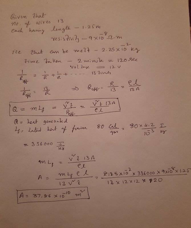

My solution to problem.
This is an old thread, but it's interesting and instructive to find the error by the instructor...
