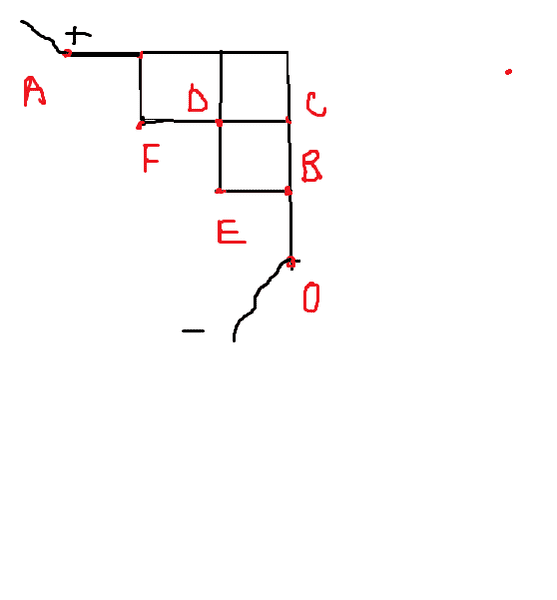

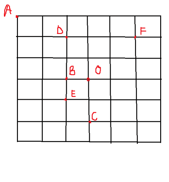

We have a resistor grid with 6x6 squres. ( figure below) If we know the voltage between ##O## and ##A##, what is the voltage between:
##a) O## and ##B##
##b) C## and ##D##
##c) E## and ##F##
Every side has the same resistance.
Attempt for solution:

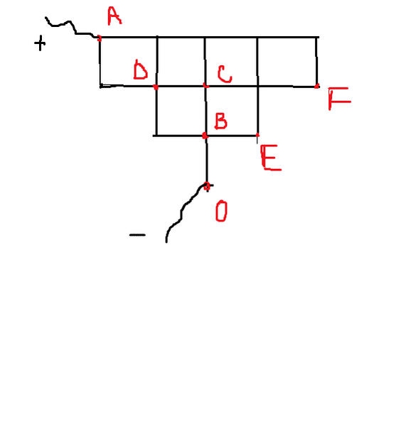

Because of the symmetry of the circuit , the equivalent circuit looks like this:
Now every resistance is half its initial value because of the parallel connection.

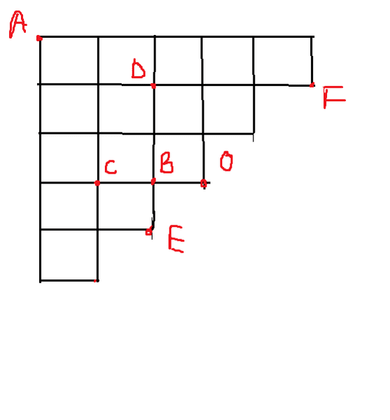

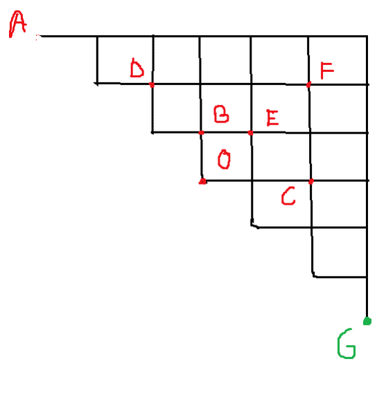

From here on I am stuck . I mean I don't really like applying kirchhoff's laws in situations like this. So I checked the solution and there the author connected the grid like this "from symmetry":
And after this:
I don't really think that these points that the author connected are equipotential especially in the first and third picture of his solution...
Am I right?

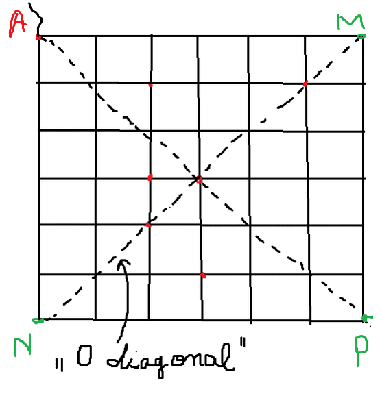

I think I got it. I had this feeling that as the current gets further away from A , is diverging more and more, but is diverging until it reaches the "O diagonal" of the square and than it converges again so it is symetric.
RingNebula57 said:
I think I got it. I had this feeling that as the current gets further away from A , is diverging more and more, but is diverging until it reaches the "O diagona" of the square and than it converges again so it is symetric.
I'm not following your description. No doubt you have a good picture of what you're describing in your mind. Perhaps you can make a sketch to illustrate?
What I was trying to say is that if we consider only point A as a potential source, than , from symmetry , we can fold the square grid twice ( connecting N-M and P-A)
A potential difference requires two points: You measure the potential at a given point with respect to some other point. Similarly for voltage sources, the potential difference is established between its two terminals. Both terminals must be connected to the circuit for the source to create potential differences within it. So if your point A is connected to the + terminal, where is the - terminal of the source connected? At point P?
If your source connections are A and P then I agree that the grid can be folded to join N-M. But P-A would not work. Any folding you do must preserve the distinct connection points of the source.

Actually there is a thing that the author says and I didn't notice. It says that the frame of this grid is made of superconducting material and only what is in the interior of the square has restistance.
And I think that this means that A and P have the same potential , because if we were to apply kirchhoff's law for voltage taking the loop to be the square frame, than we would obtain ##V_A=V_P## . Am I right?
RingNebula57 said:
And I think that this means that A and P have the same potential , because if we were to apply kirchhoff's law for voltage taking the loop to be the square frame, than we would obtain VA=VPVA=VPV_A=V_P . Am I right?
Ah! Big difference! Yes, if the entire frame is constrained to be at the same potential then that makes a huge difference in your symmetry options.
All the corners will be at the same potential and you can fold the circuit along either diagonal or even the centerlines.
Likes RingNebula57

So the major misunderstanding here is that the square frame is actually made of superconducting material, so the entire frame is a equipotential region.
Yes. As often is the case, the devil is in the details :smile:
