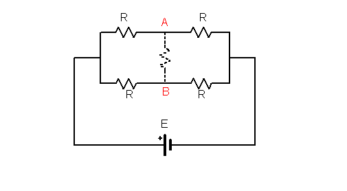

Its a very good approach that you have posted over here, it would be of help to me if you can post a method or a diagram that how would you arrange these nodes and resistance in such order.
Think of a balanced bridge circuit. No current flows through the bridge.
Circuit schematic of a resistor network: four resistors labelled R form a rectangle, with a dashed resistor between nodes A and B at the midpoint, connected across a battery labelled E.

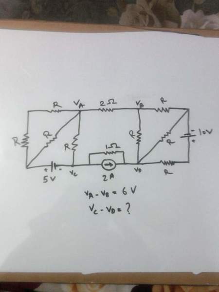

Can you solve this problem pleasez ! I am getting answer -5 volts !
New problems should be posted in their own, new threads. Also, you must show your own work/reasoning before we can know how to help you.
