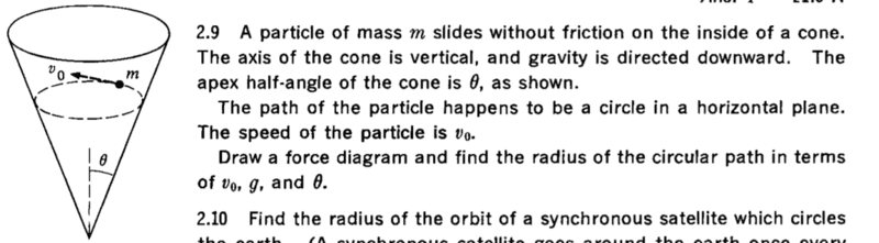

Refer the given image. [Prob 2.9]
F=ma
I drew the normal vector perpendicular to the surface of the cone and resolved it as
##Nsin\theta=mg##
##Ncos\theta=\frac {mv_{0}^2} {r}## where ##v_{0}## and ##r## are the speed and radius of the trajectory respectively.
Solving for ##r## we get,
##r=\frac {v_{0}^2} {g}tan\theta##
My doubt is however is on the matter of resolving the required vectors. Is it necessary to resolve the normal reaction into components or is it correct to resolve ##mg## along the normal and along the lateral surface of the cone? Similar situations arise when solving problems related to pendulums. I get confused whether tension vector must be resolved or mg.

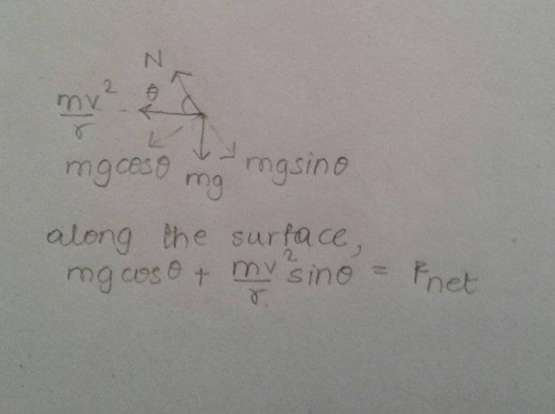

Also if any of the vectors can be resolved then when resolving acceleration and mg in the direction perpendicular to the surface and along it then we get...
(refer image).
However the body doesn't move along the surface but through this approach a net force appears. Where am I going wrong?
(refer image).
In your calculation shown in the pic, the signs are not correct. The component of gravitational force points downwards, the component of the centrigugal force upwards. If you change the sign from plus to minus (and set the result zero) you will obtain the same correlation as in your first post.

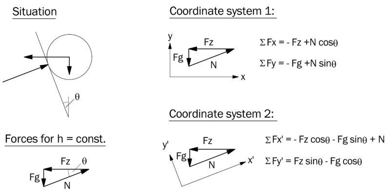

There is an elementary difference between the centripetal force, which is a "real" force, and the centrifugal force, which is an inertial, and therefore, a pseudo force. You can compare it with the application of Newton's second law:
$$m a = F_{net}$$
The net force ##F_{net}## corresponds to the real force acting on the ball by the wall (and the gravity) - the centripetal force. The LHS corresponds to the centrifugal force, which is the the resulting change of kinematic state due to the centripetal force, but since they are equal you can take advantage of the formula for the centrifugal force for movements on circular trajectories.
ubergewehr273 said:
Let's say the problem was to find the magnitude of normal reaction acting on the body. Clearly both the values of normal can't be the same (refer 2nd image). Then what's the right value of the normal reaction ?
I'm not sure if I misunderstand, do you doubt that ##N=\frac{mg}{sin\theta}=\frac{mv^2}{r\,cos\theta}## (if the height of the ball is constant)?

Your case 2 is wrong. You forgot that the total component perpendicular to the surface needs to be non-zero because the acceleration has a component that is perpendicular to the surface. The correct equation is
N - mg\sin(\theta) = \frac{mv_0^2}{r} \cos(\theta).
