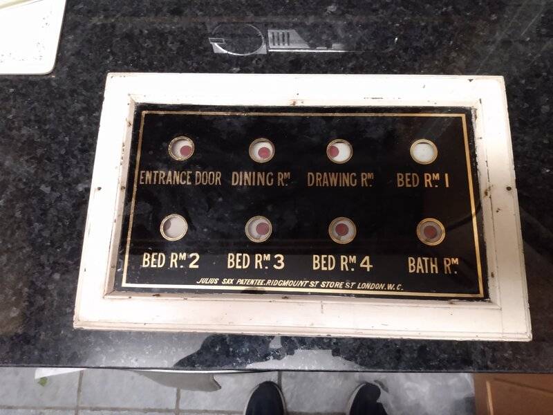

Hi. I’m hoping to restore a reclaimed butler’s indicator box – see photo’:
I’ve done a smaller one before and it was electrically trivial – a single coil for each indicator.

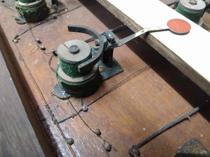

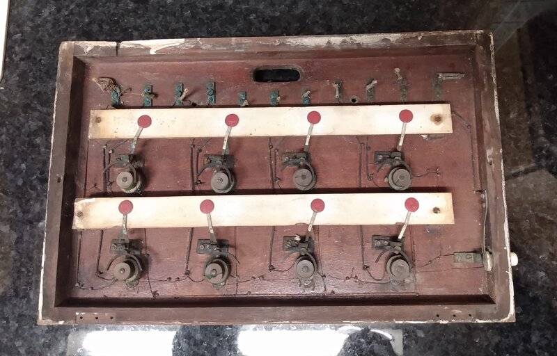

But in this one, each indicator is activated by two (differently sized) coils. And on the side of the case there is a push-button, the purpose of which is unknown. See photo’s:
Does anyone know, or can suggest, why there are 2 coils per indicator and the purpose of the push-button?
Thanks.
(Edit: I would usually get my butler to sort out this sort of thing but they are on holiday.)

One coil sets a magnetic flag when a remote button is pressed, the other clears all the flags when the local button is pressed. You will need to identify the magnetic poles of the horseshoe shaped magnets, by using a small magnetic compass, or a sense magnet. Attraction or repulsion polarity changes the state, with the state being remembered by the changed position of the horseshoe and its field.

Thank you @Baluncore. That makes sense. I hope the values of current needed to make it work properly aren’t too critical - some trial-and-error will be called for.
The panel is low voltage DC. I would expect a battery of between 2 and 6 volts would be used. The battery would connect to two terminals in the box. Polarity is important since the clear button must clear, not set, all flags.
I believe there may have been an external bell, or a buzzer, to momentarily attract attention to the indicator board. For such an early design, it may have been in series with the battery.
