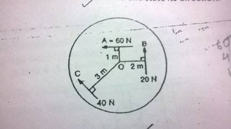

Calculate resultant moment of forces about pt O and state its direction.
Put the picture. Check it out
What I did was :
About A : 60Nm
B: 40 Nm
C : 120Nm.
I'm not sure to add or subtract for resultant. What I did::
Add. A-B as they are in same direction : 60➕40 : 100
Then subtract 120 to it as opposite direction direction
Therfore. 20 Nm
Am I right about the resultant or totally wrong?
Direction : Clockwise.
You are correct. You should specify that it is clockwise around the axis coming out of the page. In complicated situations, you define a right-hand coordinate system. Then your moments around an axis have the appropriate sign and you don't have trouble keeping track of clockwise, counterclockwise around which axis.
