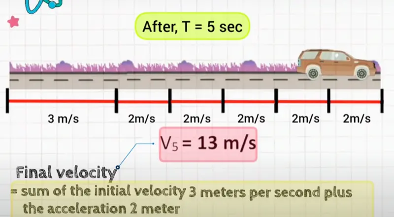

Thank you all for the insightful responses. I'd like to explore whether there’s a structured methodology that can help students better understand concepts and more effectively connect mathematics with physics. I follow a 2-step process to achieve this:
Step 1: Develop a visual definition for every term in the equation.
Step 2: Connect the mathematical operations between terms to their corresponding physical logic.
Let’s take the equation V = U + a·t as an example:
Visual Definitions:​
  • V: The displacement an object would cover in 1 second after acceleration is complete — that is, its final velocity.
  • U: The displacement the object would cover in 1 second before acceleration begins — its initial velocity.
  • a: The change in displacement per second between two consecutive seconds — in other words, how the velocity changes each second.
  • t: The duration for which this change (acceleration) is applied repeatedly.
Connecting Math with Physics:​
When an object moves with an initial velocity U, it covers U meters in 1 second. The term a·t represents the accumulated change in velocity over t seconds — since the object’s velocity increases (or decreases) by a every second, this change builds up over t seconds. Adding U and a·t gives the final velocity — essentially, the object's updated ability to cover more displacement after acceleration has acted on it.
This simple example illustrates how one can approach physics equations by visually defining each term and grounding the mathematical relationships in physical meaning. In this case, defining velocity and acceleration in terms of displacement helps students see the deeper connection.
Applying this same method to other mathematical tools and operations used in physics can lead to better conceptual understanding and help students develop a more fundamental and intuitive way of thinking.
Please watch the below video which tries to explain V=U+at in the above method.
Sorry to be negative but...
The video has the ground moving left (watch the road-markings and the purple bushes in the background) as if observing from a car moving right. So the distance-scale shown is completely wrong.
To teach velocity, first the idea of displacement (as a vector) is needed. Is there a preceding video which does this? Without it the student will not appreciate that speed and displacement velocity are different.
I found the explanation of acceleration very confusing.
Incidentally, the SI symbol for a second is 's', not 'sec'. So 't = 5 sec' is wrong.
Edit - correction as shown.
I acknowledge that the video may have several errors, and the explanation might not be very strong. However, the core idea I want to communicate is that every physical quantity can be visualized through its underlying fundamental quantity. This process of visualization can serve as a powerful bridge between the mathematics and the physical concepts it represents.

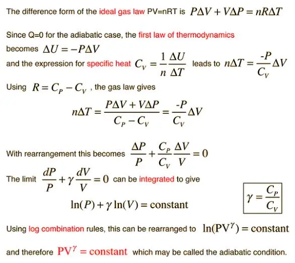

I'm currently working through a derivation to understand the adiabatic condition, and while I have no doubts about the mathematical steps, I would be very grateful if someone could help me with the physical interpretation of each step in the derivation.
I'm visualizing this as an adiabatic process involving a gas enclosed in a cylinder-piston setup. With that setup in mind, I’m trying to understand what exactly happens physically when the gas expands or contracts:
  • How is the energy distributed ?
  • Which terms in the derivation represent what physical interpretations?
Specifically, I’m trying to build an intuition for why the term
[PV][/γ]=Constant
remains constant throughout the process, and how this emerges from the physical behaviour of the system.
Any insights or intuitive explanations would be highly appreciated!
