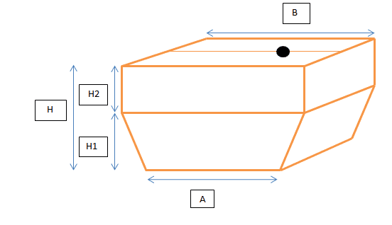

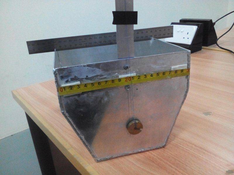

3D line drawing of a half octagonal prism with a black dot on its top face, dimension arrows labelled A (base width), B (top length), H (total height), H1 (lower height) and H2 (upper rectangular section height).
Half an octagonal prism. A small weight is placed 2 cm from the centreline of the vessel. The rod on which the weight is on is placed at (L/2) i.e at the center of the length of the vessel. The height of center of gravity from the base of the vessel is needed to be found.
Diagram of a plane surface with a rectangle on top of an inverted trapezium, labelled B for top width, A for bottom width, H1 and H2 for the two section heights, and H for total height, with the centroid marked by a dot.
In the above figure
A = 0.12 m
B = 0.2 m
H2 = 0.065 m
H1 = 0.095 m
H = 0.16 m

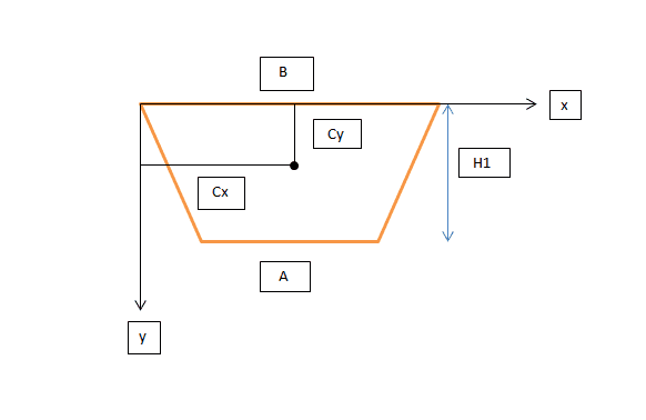

To find the centroid of the above plane surface, the centroid of each individual shapes must be first found.
The centroid of the trapezium on the x and y-axis from the top is given by the following equations
Diagram of a trapezoidal cross-section in orange, wide at top and narrower at base, with labelled dimensions B (top width), A (base width), H1 (height), and centroid offsets Cx and Cy; x-axis points right and y-axis points down from the top-left corner.
C_x= ( B/2) =0.1 m
C_y= H1/2*[((B+2A)/(B+A))]= 0.095/3*[((0.2+(2*0.12))/(0.2+0.12))]=0.0435 m

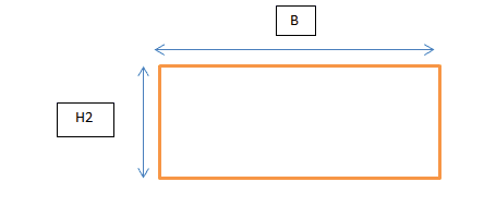

Diagram of a rectangle with width labelled B along the top and height labelled H2 on the left, both with double-headed dimension arrows.
The centroid of the rectangle is simply
C_x= B/2= 0.2/2=0.1 m
C_y= H2/2= 0.065/2=0.0325 m

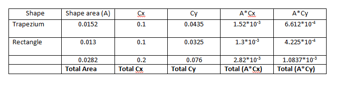

Now to find the centroid of the whole shape, the following tabular method is used
Table of centroid calculations for a trapezium and a rectangle with columns for shape area A, Cx, Cy, A*Cx and A*Cy; totals are area 0.0282, Cx 0.2, Cy 0.076, A*Cx 2.82*10^-3 and A*Cy 1.0837*10^-3.
And the centroid of the total area is then given by
C_x= (∑▒〖(A*Cx)〗)/(∑▒A)= (2.82*〖10〗^(-3))/0.0282=0.1 m
C_y= (∑▒〖(A*Cy)〗)/(∑▒A)= (1.0837*〖10〗^(-3))/0.0282=0.03843 m

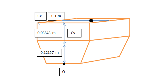

Side-view diagram of a half octagonal prism hull with a dot marking the top centroid and a point O at the base, with dimension boxes for Cx = 0.1 m, Cy = 0.03843 m and 0.12157 m.
By taking point O as the origin and taking moments around this point w.r.t the y-axis, the height of centre of gravity from the bottom of the keel (base) can be found
W1 = mass of the small weight attached
W = mass of the whole body
KG= ((W1*y1)+(W*y2))/(W1+W)= ((0.05*0.16)+(1.6*0.12157))/(0.05+1.6)=0.1227 m
I noticed several things in your calculations:
1. The rectangle and the trapezoid are both symmetric with respect to the centerline of the prism. The centroid will therefore lie on the axis of symmetry, i.e., you don't have to calculate this value explicitly.
2. You have measured the vertical center of the rectangle up from its bottom edge, and the vertical center of the trapezoid is measured down from the longer side if the trapezoid. This is incorrect from the standpoint of calculating the vertical moment of the combined trapezoid and rectangle. The location of the center of each figure should be referred to a common location. If you want to use the long side of the trapezoid as your reference, then the centroid location for the trapezoid will be negative, since you are measuring down from the reference, and the centroid of the rectangle will be positive, since you are measuring up from this reference. After calculating the centroid of the entire prism, you must correct this value to the base of the prism if you wish to determine KG.
3. In your tabular form for calculating Cx and Cy, you have shown Total Cx and Total Cy as the sum of the individual Cx and Cy values for the rectangle and the trapezoid. This is incorrect. Total Cx = Total (A * Cx) / Total Area and Total Cy = Total (A * Cy) / Total Area
4. You haven't included the length of the prism or the areas of the sides or bottom in your calculations. The presence of the bottom surface will tend to lower the KG of the prism.
5. It's not clear if the topmost surface of the prism is fully closed, fully open, or something in between. If there is a topmost surface, its presence will tend to raise the KG of the prism.
<<Moderator note: Comments on thread duplication removed.>>
That is what I did. Maybe I phrased it wrong, but if you check again, when I calculated Cx and Cy for the total area I used the equation you mentioned.

How did you come up with that equation to express the vertical centroid of the trapezoid? Doesn't the value that you got seem a little suspect?
The
The equations are from literature.
I did. If you check the table, you'll see that Cx Total is 0.2. But since both the rectangle and the trapezoid have an identical Cx = 0.1, then the Cx Total must also be 0.1.
Perhaps you copied the wrong numbers into the table?
I have measured down from the top for both the reactangle and the trapezium. Why do you feel otherwise?
With the rectangle, you can't be sure where the reference location is, since the c.g. with respect to the top or bottom is the same.
However, the correct calculation for the vertical moment requires that you use the same reference for measuring the height of the c.g. for both the rectangle and the trapezoid. In this case, since you are interested in finding the KG of the prism with respect to the bottom of the prism, then that reference location would be the most logical to choose.

Are you sure that equation is correct though (even if you were to use the same reference)? I calculated the centroid by breaking the trapezoid down into two triangles and a rectangle and I got a significantly different answer. I may very well be making a mistake, however.
I just realized that I have in fact made a mistake. Let me correct it and I will compare my value with yours.

The following link shows the formula for calculating the centroid of a trapezoid knowing the length of the bases and the depth:
http://www.efunda.com/math/areas/isostrapezoid.cfm

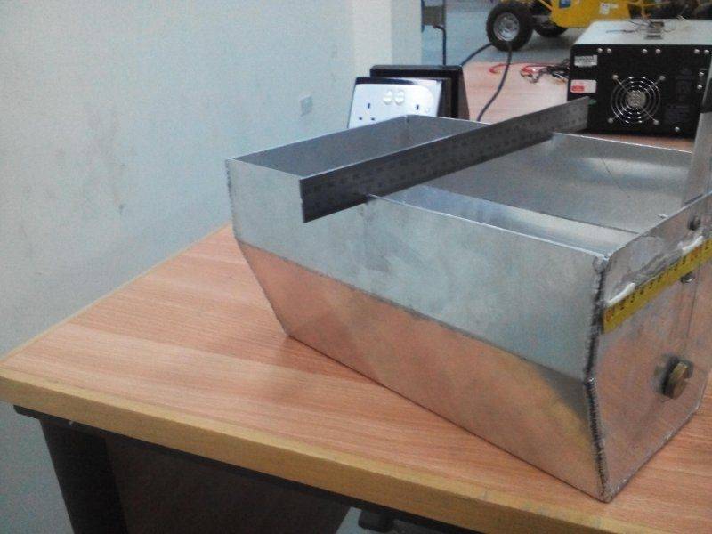

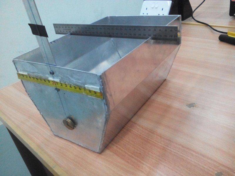

Okay, I am not sure you understand how I calculated KG for this post. I did not take mass of that specific end, I took the mass of the whole vessel (which was 1.6 kg) and assumed it to be concentrated in the center and then multiplied this mass with the distance of the center from the base.
Here are pictures of what the vessel actually looks like.
  • Photo of an aluminium tank with sloped sides on a wooden table, with a yellow measuring tape taped around its middle, a metal rule across the top, and a plumb line with a weight hanging from a vertical rod.
  • Photo of a welded sheet-metal tray with sloped sides on a wooden table, with a steel ruler laid across its open top and a metal fitting on the side.
  • Photo of a open-top rectangular sheet-metal tank with a sloped front and a divider inside, a steel ruler laid across its top and a yellow measuring tape wrapped around the front, with a drain fitting at the lower front.
