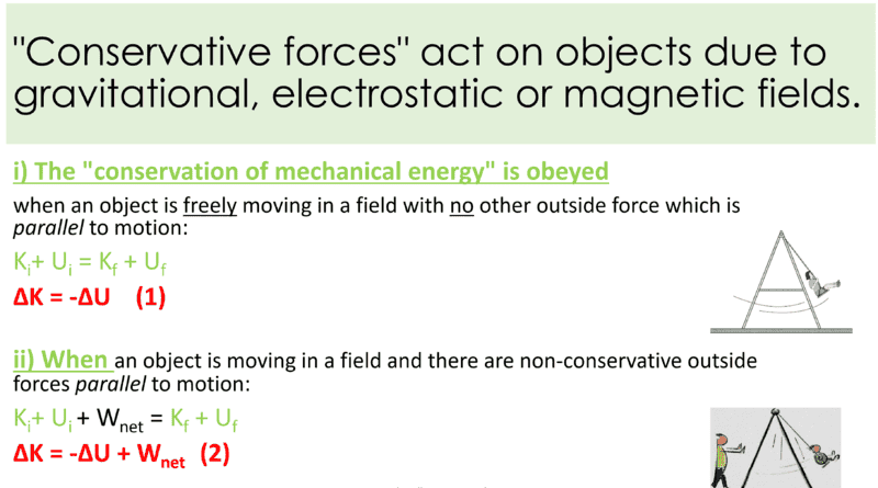

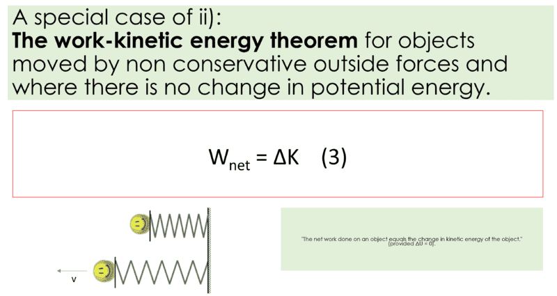

This is my latest attempt at trying to summarise but I feel there maybe a mistake in the wording. Any help would be appreciated.
Thanks.
why do you think the forces need to be parallel to the velocity?
Every force has to have a non-zero component parallel to the motion to contribute to work in that direction
ie W=Fscostheta.
yeah, exactly - a force doesn't need to be parallel to the velocity to do work
Likes vanhees71
Ok then does it sound better to replace "parallel" with "which have a component that is parallel"?
Likes vanhees71
The work-energy theorem is valid for any combination of forces. It is the most general relationship and not a special case. Conservation of energy does not apply always but w-e theorem does.
Likes vanhees71
ie W=Fscostheta.
The W-E theorem remains perfectly valid even when the work is zero. You could argue that is just as important a case as when the KE is changing.
