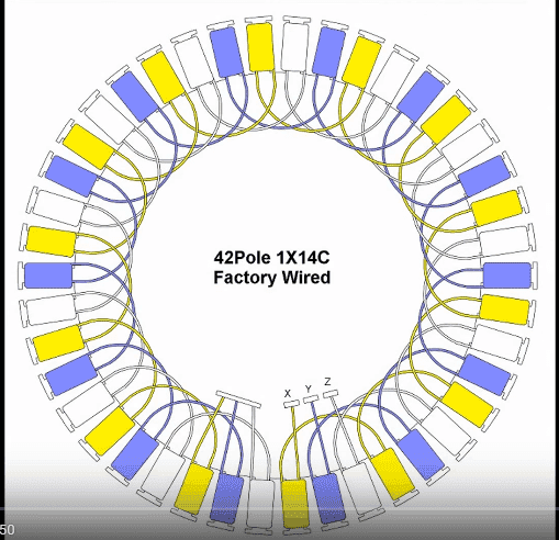

Hi all, I recently saw a video on youtube where a fellow re-wires and old stator from a washing machine in order to reduce voltage from 400VAC to a safer value. See here.
Couple of questions:
1.) A before and after image/schematic is shown with a description of the configuration. Respectively 42 Pole 1x14C & 42Pole 7x2C - What does the 1x14C/7x2C mean?
2.) What is the math behind this re-wiring? Normally I would use this formula to calculate what I need:
p = 120f/n
However (unless it's a mistake) the video shows that in both before/after shots that the config has 42 Poles - So what's the math behind this?
Before:
Wiring diagram of a 42-pole stator labelled 42Pole 1X14C Factory Wired, with coils in alternating yellow and blue and white winding groups, and terminals X, Y, Z at the bottom.

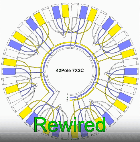

After:
Wiring diagram of a 42-pole stator with coil groups in yellow and blue, labelled 42Pole 7X2C, with a 'Rewired' caption across the bottom.

14 coils per phase in the first diagram, 7 groups of 2 coils per phase in the second.
I’m not sure what is unsafe about 400V versus whatever voltage it was converted to, nor why he didn’t just convert to delta 230V, but I haven’t watched the video yet.
