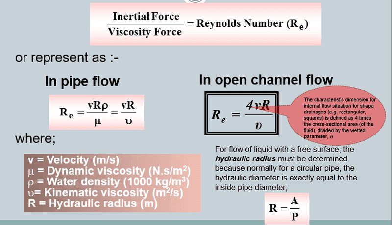

In this link , i was told that Reynold number = ρvD / μ ,
However in the notes below , i was told that Reynold number = ρvR / μ .
I think Reynold number = ρvR / μ is wrong , because i learned that Reynold number = ρvD / μ in fluid mechanics , however , in the hydraulics notes , i was told that that Reynold number = ρvR / μ . I'm very confused now

I agree. The characteristic length is the hydraulic diameter and it is confusing to use the term "hydraulic radius".

It doesn't really matter, as long as the meaning is established within the context of the system being analyzed. Anyway, it's Reynolds number, not Reynold number.

So , which is correct ? ρvD / μ or ρvR / μ ??

So , do you mean ρvD / μ is correct ? and ρvR / μ is wrong ?

Both are correct, depending on how it is used.

Can you explain further when we need to use ρvD / μ or ρvR / μ ?

In a given problem, you just need to specify which definition is being used. For example, the laminar-turbulent transition occurs at ##\rho v D/\mu=2100## for flow in a pipe, but it also occurs at ##\rho v R/\mu=1050##. So you have to tell which definition of the Re you are using.
