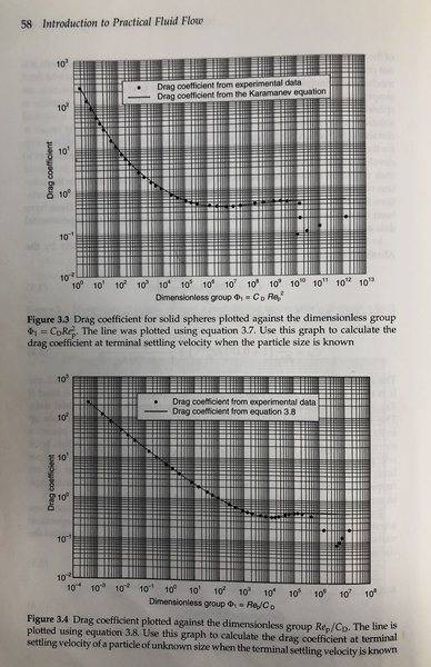

My inputs are: density of particle is 2700 kg/m3, diameter of particle is 0.001 m, viscosity of liquid is 0.002 Pa⋅s, and the ##C_DRe^2=23.8383##.
How do I build the graph ##C_DRe^2## vs Re?

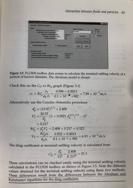

I found one method described in the book "Introduction to Practical Fluid Flow" by R.P. King (2002). Photos are attached. The example is on the last two pages. He is using similar method, ##C_DRe^2## vs ##C_D##, and this ##C_DRe^2##=[4/3⋅(ρs - ρf)⋅ρf⋅(g/μ2)]d3. Needed to find the second solution to confirm the result.
You can't know this yet because you don't know the terminal velocity.
You use the first figure you presented. You pluck points off the graph, and for each combination of Re and Cd, you calculate ReCd^2. You then plot a graph (preferably with log-log scales).
This method is basically what I indicated. I don't know what you mean about "a second solution."
I've given you enough hints for now. Together with the reference you cited, it's now up to you to work this out.
