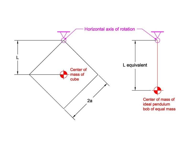

Your diagram above appears to show a vertical axis. As I understand the question, the cube is swinging backwards and forwards under gravity.
Goodwill said:
I couldn't draw it upside down but it just a illustration how the system moves
