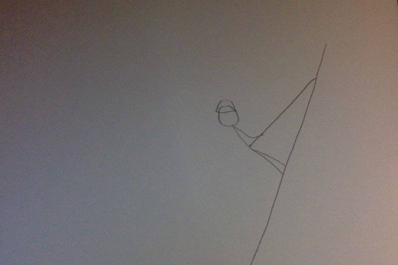

A 65kg rock climber is abseiling down a rock, consider the situation when he's in equilibrium and standing at an angle on the surface of the rock, hanging from a rope.
The rope is at an angle of 40 degrees to the horizontal, calculate the tension in the rope
W = mg.
Knowledge about components of forces.
I drew a free body diagram of the climber and used Newton's Third Law to form a right triangle with the tension as the hypotenuse which led me to sin 40 = W/T so T = W/sin 40. but the solution states that T = W sin 40 I don't understand why?
Would it be possible for you to provide a diagram? It's a little hard to picture the system you are describing.
If angle of the rock face is unspecified, there doesn't seem to be enough information provided to solve the problem.
Chet
The question does not contain enough information to yield a unique solution, however given the solution T = W sin 40° you can infer that the rock face is vertical and that the climber forms a right angle with the rope. T = W / sin 40° implies that the climber forms a right angle with the wall. If the wall were not vertical (as you have drawn) it gets more complicated.
Bad question.
As you say '' you can infer that the rock face is vertical and that the climber forms a right angle with the rope" let's assume all the conditions you mentioned were a given, then how would you go about solving the problem i.e. would there be enough information to solve it?

I read the problem a bit differently. I suggest the rope is parallel to the rock face and that the climber is standing perpendicularly to the rock face. If you assume the rope is tied to the climber at mass centre then you can show friction does not enter into it.
Yeah but the rope has to make a 40 degree angle with the horizontal.

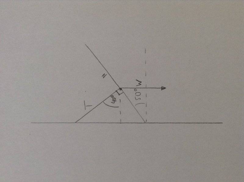

@MrAnchovy: How do I get the weight component for T = w x sin40? Is this diagram correct?
It's not incorrect, but it's not complete. Extend the rope marked T with a line. Add a line perpendicular to this extension to the tip of the arrow marked W. This triangle shows the components of W along the rope (W sin 40°) and along the body of the abseiler (W cos 40°).
