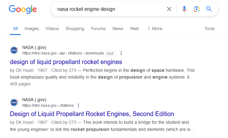

Maybe try this Google search and click into some of the many good links that it returns. That should give you a better background into the current designs:
Yes, I have searched for similar documents, but I often found general materials used in engines without an explanation of the nozzle layers configuration or a specific nozzle design. Anyway, I keep searching :)
