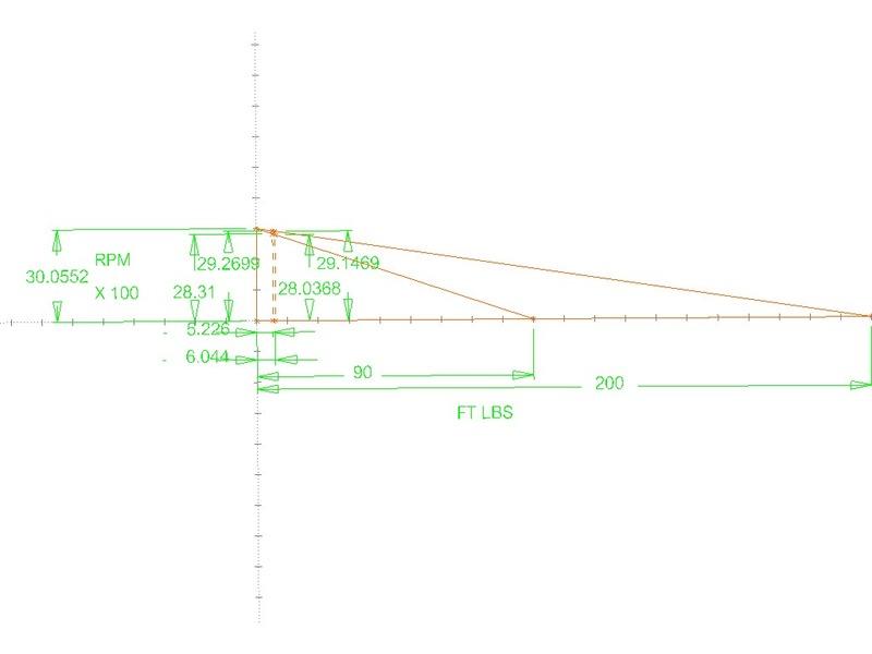

351tom
I am trying to determine rod bearing load when a 90 foot pound torque starter motor stalls. I have drawn the geometry in the picture below. I am figuring using a 10 tooth starter gear & a 153 tooth flywheel, so I calculate 15.3 x 90 ft lbs = 1377 ft lbs torque at the flywheel. So if I consider the distance traveled by the flywheel at 12 inches from it's center during a transition from 5 degrees BTC to TDC I get 1.04687 inches. During this same transition, the piston moves .00864. To calculate the effective leverage, I divide 1.04687 by .00864 to get 121.165, then I take 121.165 x 1377 lbs at 12 inches to get 166.844 lbs, and divide it by 2.704 square inches or rod bearing area to get 61,703 PSI on a rod bearing. Where did I go wrong? is the load really that high? A soft metal bearing could not endure that load could it?
[URL=http://s924.photobucket.com/user/tnoelle1/media/5c_zpsc411a418.jpg.html][PLAIN]http://i924.photobucket.com/albums/ad88/tnoelle1/5c_zpsc411a418.jpg[/URL][/PLAIN]

Starter Motor torque.
I do not know how that starter motors are rated but let us assume that maximum torque is at stall minimum velocity=0, and minimum torque=0 at free running maximum velocity.
One can plot these two points on a graph of torque vs velocity( angular ) and join them with a straight line to obtain a simple motor curve that we innocently will assume the motor to follow.
Assuming the starter motor maximum velocity is 1000 rpm as an example and that 90 ft-lbs is required to overcome stiction and all that to initiate turning the petrol engine over, and that the turning friction requires 45 ft-lbs. Matching 45 ft-lbs on the curve and we see that this starter will rotate at 500 rpm while cranking the engine.
If we now replace the starter with a beefier model capabable of twice the starting torque of 180 ft-lbs at stall but still having a free running velocity of 1000rpm, graph that and match the turning torque of 45 ft-lbs, we find a different rotational speed while cranking greater than 500 rpm. We conclude that larger starters are not necessary chosen to overcome the torque of the petrol engine but could be selected to turn it over at a faster rate while cranking.
