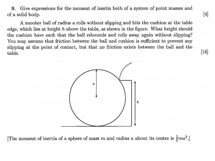

Rolling ball and impulse (Too easy to be true?)

The change in velocity = a * change in ω
I think that makes sense since for pure rolling v = aω
16 marks like that?
You've assumed the impulse is horizontal, which I don't think is right. However, as far as I can see, correcting that does not change the answer.
which direction should J be pointing then?
For change in angular momentum, it's the component of J that is tangential to surface that contributes.
For change in linear momentum, it's the component of J that is perpendicular to the surface that contributes.
From this case, J has equal components on both, hence the angle should be 45 degrees with respect to the tangent at the point of contact. How do I show this?

I don't know straight off, I just don't think you can assume it's horizontal. The ball strikes the cush obliquely. If there were no friction between the two you should take the impulse as perpendicular to the surface of the ball. Note that that would imply another impulse vertically from the table. But there's no slip between the ball and cush so it's not immediately clear which way the impulse will act. Because of the spin of the ball it could be above the horizontal, causing the ball to lift off the table slightly.
You're taking moments about the point of contact of ball with table, right? And you're taking h as the distance from there to the line of the impulse. So you need the component of the impulse orthogonal to that h. I believe that will be the horizontal component of it.
Again, you only care about the horizontal component for your equation. That's why I concluded your answer turns out to be right anyway.

I think that when there is unlimited friction the impulse will be so as to directly oppose the relative motion. In the OP case, that means it will be perpendicular to the line joining the point of contact with the cush and the point of contact with the table. This will likely give a different answer to the one you posted. But there's a problem then with the OP: if h < 2a, it implies the ball will become airborne briefly, not simply roll the other way. So now I tend to think the problem is not well posed.

if the table wasn't there, the ball would rotate down about the cushion, so clearly there's an impulse I from the table as well as the impulse J from the cushion
we know I must be vertical (because no friction at the table)
and we know Jy = I (because the ball doesn't rise, and because continuing forces like gravity can't be impulsive)
so try finding I and Jx :wink:

But the ball is initlially rolling, so as far as the cushion is concerned it is spinning. This will definitely change the angle of the impulse. It can't be just anywhere. It must be in a direction dictated by the known facts, and I see no alternative but to suppose it directly opposes the relative motion of the contacting surfaces.

I'm not looking for a shortcut. I'm looking for a logical basis for determining the direction of the impulse. What you suggest doesn't provide one. There's no way to determine the changes in momentum and angular momentum without knowing which way the impulse acts.
So far, I've only been able to deduce a range of possible heights, h (with unscientifics's value of 7##a##/5 as one of the extreme values). I believe I've made complete use of the angular and linear impulses. I don't see what else can be used. Does tiny-tim have something up his sleave? :smile:
Thanks TSny. What do you think of my argument that for no slippage on contact with the cushion the impulse must directly oppose the relative motion at point of contact? If I think of it as an elastic collision over time, with the cushion becoming compressed, it seems to me that that will be the direction of the elastic force.

You're saying that just before the collision with the cushion, the point of the ball that makes contact with the cushion has a velocity ##\textbf{v}_0## that is perpendicular to the line connecting the point of contact with the cushion and the point of contact of the ball with the table. That makes sense, since the ball can be thought of as instantaneously rotating about the point of contact with the table.
And then you are arguing that the impulse should be in the opposite direction to ##\textbf{v}_0##. I'm going to have to think about that. Right now I don't see why there couldn't be a component of impulse along the line connecting the two points of contact. Maybe you can help me see that.

At the point of contact of ball with cushion, you can think of it as linear motion. It might as well be a rectangular block landing flat (but traveling obliquely) on the ground. The surfaces compress, without slipping, until instantaneously at rest. The force therefore directly opposes the motion; if there were any lateral force rest would not be achieved. Decompression should be like time reversal.

I can see how this argument would apply to a particle striking the cushion. But I don't see (yet) why the argument is valid for the sphere striking the cushion. If you consider a small volume element of the ball at the ball's surface where contact is made with the cushion, then that small element is going to experience not only the force from the cushion but also complicated forces from neighboring volume elements of the ball. It's the sum of all of these forces which brings the volume element momentarily to rest.

We can represent the motion of the ball as a sum of a linear motion and a rotation in any number of ways. If we centre on the part that contacts the cushion, the rotation about that point is immaterial to the forces in the impact (except as second-order effects over a longer time). It's like a rolling contact.
