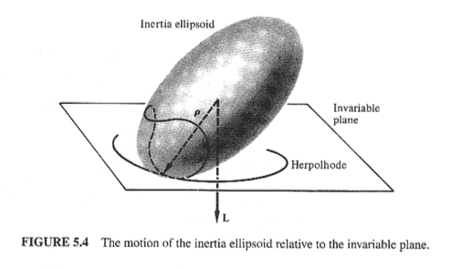

Suppose the symmetry axis is along the ##x_1## axis, then the principal moment of inertial about the symmetry axis is ##I_1##, according to (5.35) and (5.33). And from Fig 5.4, the semi-principal axis along ##x_1##, the symmetry axis, is longer than those along ##x_2## and ##x_3##. Thus ##I_1## should be more than ##I_2## and ##I_3##. Isn't it?

But if we slip the inertia ellipsoid along the herpolhode, we can still have the vector ##\rho## invariant in the inertia ellipsoid since the point of contact does not change and the relative orientation of this point with respect to the rest of the ellipsoid (and to the body axes) does not change too. So it seems like slipping allows the instantaneous axis of rotation to be at rest in the body coordinates.
I think the point is this: If you are slipping, then the body is not rotating around ρ but around the body's symmetry axis. (This is most obvious for pure slippage, that is, no friction). ρ ceases to be instantaneously at rest.
