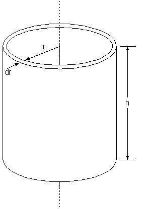

What's the material volume of a thin cylindrical shell of radius r and thickness dr?
Yeah, went afk for dinner and worked on it a bit before checking back here, sorry. So, would I be correct in having that...
dV = hπ(r+dr)^2-hπr^2=hπ(2rdr+dr^2)
I seem to remember things like dr^2 can be discounted as being pretty much non-existant?
M = ∫ρ dV = 2πh∫ρr dr = 2πh∫1600r-18000r2 (Hey, I was using 900/5 instead of 900/0.05 above. Well that was stupid and explains a lot.)
M = 400πh∫R08r-90r2 = 1.1

It's even simpler than that. If the shell is very thin (as in "dr" thin), then a differential approximation for the volume of the shell is the surface area at radius r multiplied by dr. It's as though you've taken a rectangular sheet of paper of thickness dr and formed a cylinder out of it. The surface area is just 2 \pi r h, so the mass element is 2 \pi h r \rho(r) dr.
And was I=MR2 the right equation for MoI?
Yes, the moment of inertia of a thin-walled cylinder is MR2.
