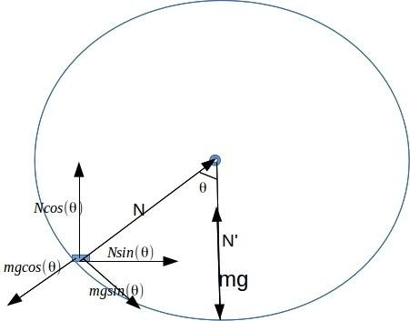

A small body A is fixed to the inside of a thin rigid hoop of radius R and mass equal to that of the body A. The hoop rolls without slipping over a horizontal plane; at the moments when the body A gets into the lower position, the center of the hoop moves with velocity v0. At what values of v0 will the hoop move without bouncing?
mgcos(θ)−N=mv2/R
One equation will be the energy equation. The velocity of hoop and mass A will reduce as the body A is gaining the potential energy.
  • Free-body diagram of a small body on the inside of a circular hoop at angle θ from the vertical, showing normal force N toward the centre, components Ncos(θ) and Nsin(θ), and weight components mgcos(θ) and mgsin(θ), with mg acting downward.
  • Diagram of a circular hoop rolling on a horizontal surface, with center O marked, a point A on the inside of the rim near the bottom, and a radius line from O to A.

What will cause the hoop to bounce? Think of the force on the mass A and the centripetal force required to keep it rotating when mass A is at its highest point (highest velocity).
