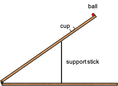

Here is a nice demonstration of this idea. Two planks are hinged at one end, opened at about 35° and held in place by a support stick. The tilted plank has a small ball at its tip prevented from rolling by a dimple in the wood. A small metal cup or can, is screwed in place at an appropriate distance from the plank's tip.
Question: How can you put the ball in the cup without touching it?
Answer: Yank the supporting stick away.
How does it work? The tip's acceleration has magnitude greater than ##g## which means it separates from the ball fall. The ball falls freely in a straight line towards the point directly below it. The cup describes a circular arc and stops in time for the ball to drop in it.
This demonstration works 100% of the time after the initial time investment of screwing the cup at the right spot (##L\cos\theta## from the hinge - small adjustments may be necessary). I highly recommend it and the students are impressed. It is a good idea to put some lossy material (silly putty works best) inside the cup to prevent the ball from bouncing right out.
